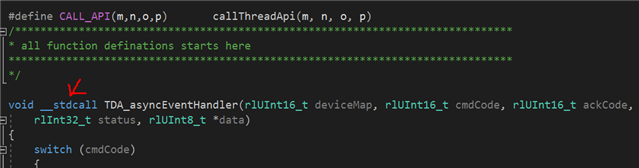

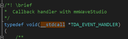

  • One of the engineers on out team had a similar issue connecting with the TDA as mentioned at to of this thread:
    He observed the following and made the following change, which so far, has resolved our issue with TDA Connections
    Observation:
    MMWL_TDAInit registers the callback and typecasts the callback to TDA_EVENT_HANDLER, which is defined as follows in mmwl_port_ethernet.h
    which requires a function to have __stdcall signature, but in properties (C/C++ advanced) for the project, calling convention is "__cdecl"
    The fix for us is to cast this function to __syscall
    in mmwave_example.c (cascade example)
    I will mark this as resolved.
