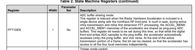

IWR6843: Is it possible to use the ADC buffer sharing mode 68xx devices?
Part Number: IWR6843
In the Hardware accelerator user guide (part 1) it is explained that for mmwave 14xx devices an ADC buffer sharing mode alows the ping and pong memories of ADC buffer to be shared with ACCEM_MEM0 and ACCEL_MEM1 of HWA. (see image below)
In the HWA user guide nothing is said about mmwave 68xx devices.
Is this functionnality nonetheless available in 68xx devices or not ?
