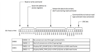

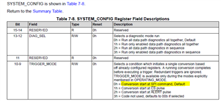

I am trying to understand the functions of the TMAG5170 sensor and would like to understand how the trigger works.
The CMD0 bits provides information that
0 - Start conversion on SPI command
Does this mean that any SPI command triggers the conversion ?  Or
Only the read of the particular register initiates the conversion ? Or
Is there any other specific command to start the conversion?

    The SPI command for TRIGGER_MODE=0 is referring to the CMD0 bit in the SPI protocol.
    With this setting, a conversion may be triggered if desired by setting CMD0 to 1 during any SPI transaction.  The conversion should begin after the last SCLK edge. CMD0 will only impact device operation when CMD0 = 0.
    If TRIGGER_MODE = 1, then this conversion will be started by the CS pin being driven low
    If TRIGGER_MODE = 2, then this conversion will be started by driving the ALERT pin low.
    Scott
  • Thank you Scott for the response.
    Could you please confirm if my understanding is right:
    To start the conversion and read data using an SPI command below is required
    1.  Set trigger mode to 0 (Configuration)
    2. Set CMD0 to 1 during a read/ write sequence.
    3.Confirm reading CONV_STAT that the recent data is present.
    4. Read the Conversion result.
    Thank you,
    Aditya
  • Aditya,
    This is the correct sequence.  You should be able to combine 1 & 2 into the same SPI transaction.  Step 3 is optional if you plan timing carefully, but is good practice.
