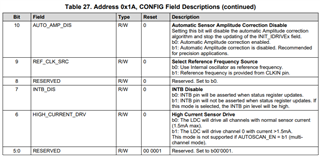

11cm is a fairly large coil size, do you know the Rp or Rs of the coil? This might be a current drive issue for the device. Have you tried putting the LDC1614 into high current drive mode? (bit 6 of the config register)
Justin Beigel
Rs = 3,2 Ohms

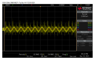

When I change bit6 config to 1, the signal oscilates in mode streaming.
Can you send an oscilloscope capture of the output for both cases (bit 6 to 0 and 1)?
Thank you,
Justin Beigel
The captures look fairly noisy, how are you connecting to the sensor? Also, is there anything else involved in the circuit or is it just the EVM with the sensor?
