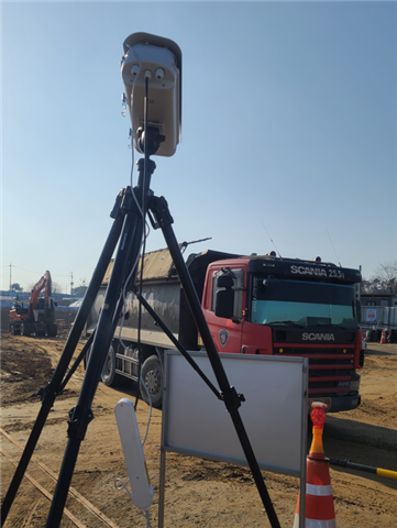

I am evaluating with IWR6843ISK.
It is being developed while testing in a real environment.
The environment is as follows.
  1. radar installation
    1. height : 2m~2.3m
    2. tilt degree :  about -2.0
  2. radar configuration file
    1. long range people detection 50m 2D
  3. object to be detected
    1. truck
    2. people
I conducted the test in the above environment. As in the picture above, if one truck is detected, no problem occurs.
However, when 2-3 trucks appeared, the radar didn't work anymore.
(At this time, I did not use the matlab monitoring GUI in mmwave_industrial_toolbox and checked radar data with python.)
I checked if python was wrong, but there was no problem.
So, I verified with IWR6843ISK and matlab monitoring GUI in my office.
In my office, it was not possible to test in an environment like the picture above.
I tested the assumption that the radar stops when a large number of point clouds and objects are detected.
I tested the radar by shaking it left and right without fixing the radar in the office. Then, the same symptoms were confirmed.
IWR6843ISK no longer prints UART.
Below file is record file when shake radar left and right without fixing the radar in the office.
4-matlab.txt
Please check it.

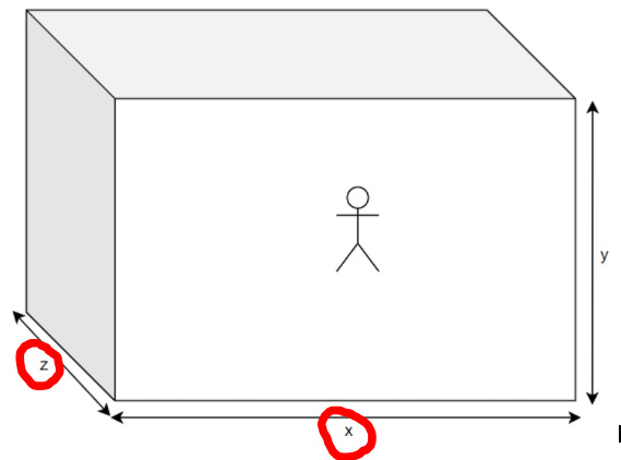

    2) What is the expected result for the scene of interest - Detecting object x at Y distance, moving not moving?
        -> I would like to know x,y distance of both moving and immovable objects.

    2) Objective is the detect objects and their location.  - correct?
    2.a) Which object was present in the scene and what the the equivalent point cloud show?
    2.b) Have you tried to use the  heatmap plots to see what is perceived by reflections before creating point cloud. Knobs for this are available in the SDK UG.
    We will get to #3) and #4) after we have an idea of objective and demo in use.
    Thank you,
    Vaibhav

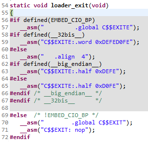

  • Hi Vaibhav
    I executed example by CCS.
    The result is also UART output stop.
    I checked console message in CCS as below
    "{module#9}: "C:/ti/mmwave_industrial_toolbox_4_8_0/labs/common/src/dpc/objectdetectionandtracking/objdetrangehwa/src/objdetrangehwa.c", line 640: error {id:0x10000, args:[0x2136c, 0x2136c]}
    xdc.runtime.Error.raise: terminating execution"
    and stop in exit.c as below
    please help me.
    What I believe my be happening is that the amount of data that you are sending over UART is to large such that by the time the next frame arrives the data hasn't completed sending. To test this please increase your interframe time (ms) by modifing your configuration file. The inter-frame time parameter is found in the frameCfg CLI command. The documentation for this command can be found at the following resource:
    SDK User Guide:
    <MMWAVE_SDK_INSTALL_PATH>\docs\mmwave_sdk_user_guide.pdf
    Connor
