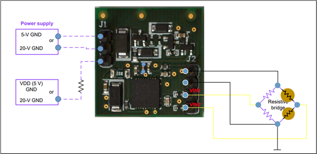

I am going to develop a thermal conductivity gas sensor application like below image.
I don’t yet know a actual bridge output value, but I expect that bridge output value is approximately 0~200mv and it is dependent on tolerance and Temperature Coefficient of sensor heater.
Also, analog output of gas sensor application is 0.5~4.5V corresponding to gas concentration and output resolution is under 0.1V.
I have questions about sensor signal processing.
First, How do I design AFE Circuits using TI’ ICs or others after wheatstone bridge output?
Second, how many bit ADC resolution does mcu need?
I would like to need your many help and ideas.

  • Seunguk -
    I would imagine then here you would need to arrange your circuit something like this, where they elements in yellow circles would represent your sensor, in the bridge and then going to the device used in this reference design. I am moving this post to the appropriate product line for further support.
    https://www.ti.com/lit/ug/tidubh0b/tidubh0b.pdf
  • Josh, Thank you for your answer.
    In addition to your answer, I would like to know how to design AFE circuit  without ASIC(PGA400).
    The reason is that I must use MCU to calibrate and compensate our gas sensor to meet our customer's requirement.
  • Hi Seunguk,
    Take a look at this App Note on Wheatstone Bridge signal conditioning: www.ti.com/lit/an/sloa034/sloa034.pdf  From there you can go to your micro-controller and there is no need for the ASIC,.
