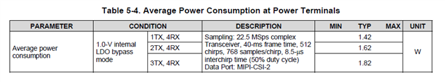

Hello Champs,
There is only Average Power Consumption on awr2243 datasheet.
Customer wanted to know the Maximum power consumption for every antenna. Do we such spec?
Thanks.
Rgds
Shine
  • Hello Shine,
    Are you asking about the change in current during the active chirp period with reduction in the number of TX used? The active current will reduce ~300-350mA on the 1V power rail when you disable 1Tx.
    Vivek
