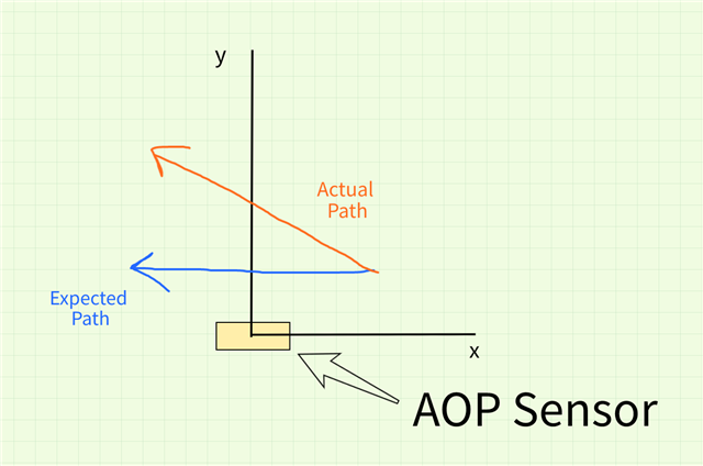

My team recently ran an experiment with the OOB demo. We set up the sensor on a desk with the front face (see image 1) facing outward toward the room. We then had a person walk from one side of the room to the other in front of the sensor. We captured the point-cloud data using a Python script, and then plotted the x and y data. The sensors were able to pick up the person's movement, put not in the direction expected. Instead of traveling in front of the sensor at a constant y value, the data shows the person traveling at an inclined path on the xy-plane (see image 2).
I'm a bit confused on where this difference is coming from. Is there a diagram somewhere showing where the origin and x, y, and z axes are relative to the physical device?

  • I'm having trouble visualizing the comparison between the axes in the documentation and the AOP antenna positions. Can you review the axes (where the y axis is going into and out of the image) that I drew over the figure and confirm if they look correct?
    Your axes drawn on the image above are correct along with your expected path. Thank you for sharing your config file.
