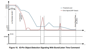

    Below is a figure from the PGA460 datasheet displaying the echo signal in red and the threshold setting in blue. Here, you can see the threshold setting changing with respect to time. This allows the initial burst energy to be ignored, and the expected return echo to be qualified .

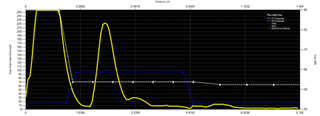

    There are many methods to set threshold, but most require trial and error for best results. The PGA460-BOOSTXL EVM has a GUI that allows the user to easily see the receiver output plotted with TVG and threshold maps, see below:
    Generally, most threshold maps look similar to this, A high initial threshold(white) is used to avoid triggering on the burst, then the threshold is lowered to somewhat follow the ring down of the transducer, and finally stabilizes around a stable value for accurate threshold detection. Note, I use the TVG(blue) to ensure the receive echo amplitude is high enough for detection yet also avoiding saturating the ADC. I ramp my TVG down around 4ms as I do not want to detect any TOF measurements longer than 4ms in this particular implementation. A similar result can be be obtained by raising the threshold settings after the maximum desired TOF time is reached.

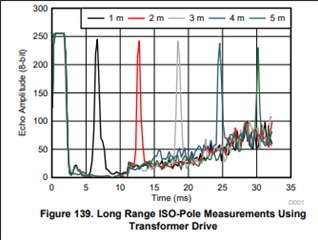

    Here is an example of a well tuned PGA460 used for range measurements from 1m to 5m
