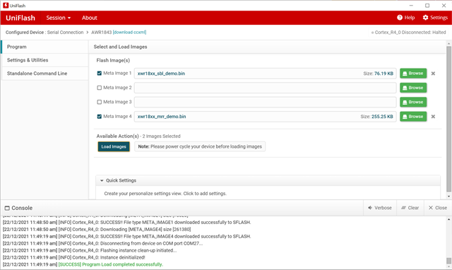

I am testing our customised device with automotive lab demo sbl.

Test:
1. Flashing multiple images into the device by using UniFlash.
2. Reboot the device and monitor the sbl log, I get the "Error: Meta header absent!!!" in flash address: c0180000.
3. I added Debug Log to metaheader_parser.c and saw that the value of meta header start is 0xCCCCCCCC. It seems that sbl has not read the image correctly from the flash.
This error doesn't occur in AWR1843Boost. It works for loading image from flash in AWR1843Boost.
