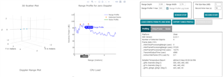

    Have you tried the heatmap plot? I did several times with very 1 fps. I never worked. I was using awr2944_mmw_demoTDM.appimage
    Thanks!
    Hang
  • Hi Hang
    Yes, I tried awr2944_mmw_demoTDM.appimage.
    It seems ok.

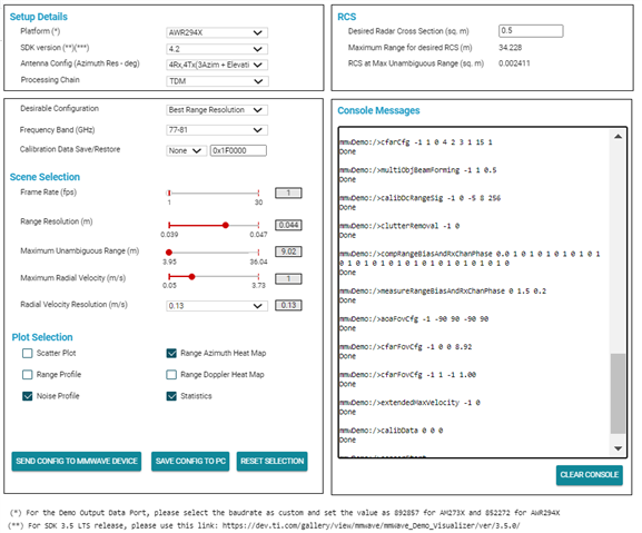

    Are you mixing AWR2943 up with AWR2944? like the image name and visualizer setting.  and the baud rate should be set as 852272.
    or maybe you can check the settings with my settings.
    When I tried first time, I flashed awr2943_mmw_demoTDM.appimage without noticing.
  • Hi Ken,
    Thank you so much! I think I was using awr2944 and set the baud rate (data port) to 852272.

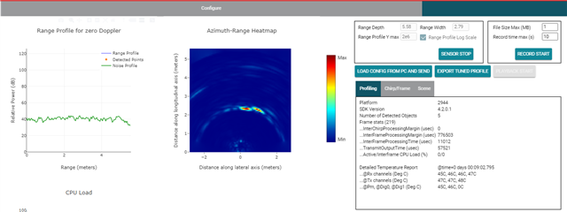

    1. Yes , these images can be referred as OOB demo image. But if you want heatmap output, you may need  to flash the TDM.
    2. I think your cfg file  is correct.
  • Hi Ken,
    Thank you so much! It worked.
