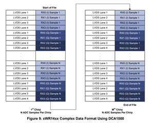

I need to understand what is the CSI raw data order received.
In swra581b.pdf chapter 5 it is stated:
But on AWR2243 data-sheet chapter 9.4 it is stated:
So which one is it ?

Hello Ron,
Refer to the AWR2243 Datasheet, Section 9.4.1 to get an idea of the raw ADC data through the CSI2 interface.
The datasheet talks about this format very briefly. Since AWR2243 device uses MIPI D-PHY / CSI2-based format to transfer the raw ADC samples to the external MCU, you could also refer to the MIPI Standard directly.
Your first picture and reference to swra581b.pdf, talks about the LVDS interface.
Hope this gets you started.
