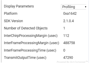

The radar board runs on the following files is:
high_accuracy_demo_16xx.cfg and  xwr16xx_high_accuracy_lab.bin
I have configured the radar board and tested it according to the instruction manual, I have encountered several problems, can you please answer them?
1.In the process of pedestrian detection, when detecting multiple people, only one point is detected, and the distance information detected is only the distance information in the Y-axis direction, and there is no information on the X-axis.
2.When I use the radar board to measure the level, there is no detection information. What is the reason for this?

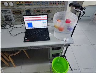

  • The devices I have purchased are IWR1843BOOST, IWR1642BOOST and DCA1000EVM.
    My technical requirement was to perform level measurement on the upper surface of a coal bin, to measure as many points as possible and to display height information at different points.
    After the material level measurement is completed, the points are to be connected to form a spatial surface, as shown below:
