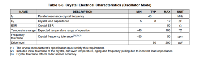

We are currently using an IQD LFXTAL071773 crystal with the IWR1443 but that crystal is unavailable. Is there a list of crystals that have been qualified with that chip that I can pick a cross from?

Hello Lindsey,
You can use any xtal that meets the electric XTAL specs mentioned in the 1443 datasheet . The temperature range requirements depends on your system temperature range of operation. The PPM error can be relaxed to 200ppm for most applications.
