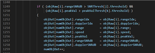

Hello Team,
I want to set to track only objects with a speed less than 0 in the Y dimension. How do I set it in the Kalman filter?

Can you please try something simple by putting a mask on TLV with speed > 0 and let me know if this solution works for you?

Thanks for your patience. As you want speed < 0 objects only to be detected (ie objects moving towards radar only), can you please add a condition in dss_data_path.c, in function rangeBasedPruning (lines 1249 -1250) as shown in snip below:
"&& objRaw[numObjOut].speed<0" and recompile the lab again and see if this helps you to achieve what you had wanted.
Let me know if you have any questions.
