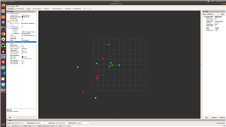

I have an AWR 1843 mmwave radar sensor and try to obtain 3d point clouds by runing the ROS package of "ti_mmwave_rospkg" in ubuntu 18.04. Although AWR 1843 can successfully work with ROS together, the quality of point cloud data is poor. As shown in the following figure, we can't distinguish objects from point clouds data at all which looks like a few chaotic points.

    As mentioned in the video the point cloud is accumulated over a quarter of a second time period.
    This is he first thing you should configure in ROS.
    You can also try to lower the CFAR threshold in the configuration.
    What is the .cfg that you have used? profile_3d.cfg?

    1) I'm still a beginner in ROS, What should I do to accumulate the point clouds data in a quarter of a second time period?
    2) How can I reduce the CFAR threshold in the configuration? Here have two "cfarCfg" and two "cfarFovCfg" in .cfg file.
    cfarCfg -1 0 2 8 4 3 0 15 1
    cfarCfg -1 1 0 4 2 3 1 15 1
    cfarFovCfg -1 0 0 8.92
    cfarFovCfg -1 1 -1 1.00
    3) The .cfg which I used is $(find ti_mmwave_rospkg)/cfg/1843_3d.cfg. The path in my ubuntu os is "/home/xiaochen/workspace/mmwave_ti_ros/ros_driver/src/ti_mmwave_rospkg/cfg/1843_3d.cfg"

  • Hi, Cesar,

    So, as you mentioned, I try to lower the value of CFAR threshold and no grouping. Then the "cfarCfg" have been changed as:
    cfarCfg -1 0 2 8 4 3 0 12 0
    cfarCfg -1 1 0 4 2 3 1 12 0
    It did work, I can capture more points in RVIZ. However, these points jump back and forth which looks like the noise, especially if the object is moving.
    Sincerely look forward to your answer!
    thank you
    The meaning of the commands in the .cfg is documented in the mmWave SDK user guide
    C:\ti\mmwave_sdk_03_05_00_04\docs\mmwave_sdk_user_guide.pdf
    Yes, if the CFAR threshold is lowered the "noise" is expected to increase. This the reason why you should only decrease it as a last resort. Also you should try one decreasing it progressively.
