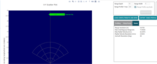

I'm using IWR6843ISK radar module and do some tests with OOB demo. The purpose of tests is to investigate maximum range dependence of slope of the chirp.
For theoretical calculations i use formula:
IWR6843 module has maximum IF bandwidth of 10 MHz, when ADC sampling rate is set to maximum value.
For example if slope is configured to 76.9 MHz/uS then:
Rmax = 19.5 m.
I expect to not see any detected object beyond range 19.5m, but when i do test with walking human radar detects human at range > 19.5m. Screenshot of this test:
How i should interpret these results when object is detected beyond maximum theoretical range?
Full configuration of radar:
profile12.cfg
Thank you,
Rytis

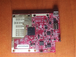

  • Please help us confirm the following:
    1. SW version used on the device. Which TIrex or SDK version was used.
    2. Picture of the device marking on which this was used.
    THank you,
    Vaibhav
    Than You for quick response.
    In calculations i use IFmax value from IWR6843 datasheet.
    1. SDK version - 03_05_00_04. OOB demo firmware from Industrial Toolbox 4_7_0 labs.
    2. Picture of radarMMWAVE Boost picture
    Thank You,
    Rytis
  • Hello
    The additional detection range you are seeing can be because of the roll-off region of the IF Frequency filter range.
    We recommend using the Device Datasheet values as the limit for valid detection ranges.
    THank you,
    Vaibhav
  • Hello
    I want to clarify several things.
    In my configuration slope is 76.9 MHz/uS. Detected object distance from radar is ~23.2 m(could be seen in picture). From Rmax formula we could calculate IF frequency at this range:
    In IWR6843 datasheet there is line:
    1. Nyquist frequency of maximum ADC sample rate(25Msps) is 12.5 MHz and according datasheet there is at least 60 dB anti-aliasing attenuation. 11.89 MHz is really close to 12.5 MHz. Is it still possible that radar pick up IF signal of 11.89 MHz?
    2. Recommendation is to ignore everything that is beyond theoretical Rmax?
    Thank You,
    Rytis
  • Hello Rytis,
    1. 11.89 MHz is really close to 12.5 MHz. Is it still possible that radar pick up IF signal of 11.89 MHz?
    Consistent performance across devices can be guaranteed by following the IF max limits provided by the device data sheet and basing your calculations off that value.  The provided max values should be used for calculations and theoretical computations.
    As stated above, the theoretical Rmax is your limit for valid object detection ranges.  The device may pick up objects further than the theoretical max range, but the accuracy cannot be guaranteed.  For this reason, we recommend using the device datasheet values as the limit for valid detection ranges.
    Brennan
