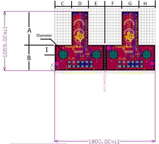

Hi Team,
Our customer would like to request for the technical drawing, CAD model or dimension of the TMAG5273EVM evaluation module. I have searched the forum and the product page but didn't find this information. Can you please share a copy?

  • Hi Danilo,
    The below picture shows the dimensions of the TMAG5273EVM.
    Mekre
  • Hi Mekre,
    Thank you for providing the dimensions of the evaluation module. Can you please provide also the dimensions of A to I and hole diameter. It seems that the grid dimension is 50 mils but it would be great if you could provide the official dimension.
    Danilo
  • Hi Danilo,
    The dimensions are below:
    • A=599mils
    • B=460 mils
    • C=F=302 mils
    • D=G=300 mils
    • E=H=298 mils
    • Holes
      • Hole diameter=150 mil
      • Bottom left point of “B” dimension to center-point of most-left hole is 152 mil in the x direction and 284 mil in the y direction.
      • Distance from 1st left hole to 2nd left hole=600 mil
      • Distance from 2ndt left hole to 3rd left hole=300 mil
      • Distance from 3rd left hole to 4th left hole = 600 mil
