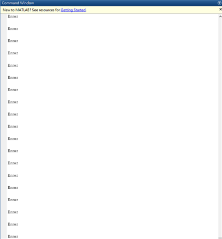

We refer to the lab0015high_end_corner_radar and record the radarCube which
has been compressed through AWR2944 DDMA process, and now we want to
decompress the radarCube by PC. We use the decompression Matlab code provided
by mmwave_industrial_toolbox_4_10_0\tools\memory_compression\matlab.
The decompression parameters show below:
The difference between example (test_main.m) and our experiment is only
numAdcSamples, numChirps, numVirtualAnt parameter. When we run the
decompress_data function
It will appear Error when the program run to the “black box” which is named
ExpGolombEncDec whose file type is Mex. The Error shows below:
We want to know what reason make there error and how to fix it? We also
want to know what this “black box” actually do when decompressing the data?
Jen
  • Hi Jen,
    I think the number of samples per block should be 32. This is because the lab combines 8 range bins, and 4RX channels per bin, totaling 32 samples. Could you try using 32 and seeing if that works? Could you also try all available radarcube formats? I haven't worked with the Matlab script for decompression, and am not sure what the three radarcube formats mean exactly.
    Aayush
  • Hi Aayush,
    I have changed the samples per block to 32 but the Error also appear and the radarcube is formats2 in AWR2944.
    Could you help me understand the input parameter format when using decompress_data function, especially first parameter of this function?
    Or whether there have another C code or file that can help us resolve the decompression problem?
    Jen
