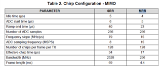

I am currently using the MMWCAS-RF-EVM (AWR2243 SOC) with the MMWCAS-DSP-EVM. I am currently running the cascade_configuration_MIMO lua script. I do have several questions with regards to the chirp parameters.
My intent is to use it for the measurement of some Corner Reflectors around 20m, possibly 30m both static, and in moving scenarios (radar static target moving; radar moving, target static; radar moving, target moving).
I have referred to the programming chirp parameters in TI Radar Devices pdf guide as well as the Imaging Radar using cascaded mmWave Sensor Reference Design (TIDEP-01012), and decided on the following table
I've attached the parameter portion of the lua script below (taking MRR in table 2 as a reference),
-- Profile configuration
local profile_indx              =   0
local start_freq                =   77     -- GHz
local slope                     =   15     -- MHz/us
local idle_time                 =   4      -- us
local adc_start_time            =   5      -- us
local adc_samples               =   256    -- Number of samples per chirp
local sample_freq               =   15000   -- ksps
local ramp_end_time             =   23     -- us
local rx_gain                   =   48     -- dB
local tx0OutPowerBackoffCode    =   0
local tx1OutPowerBackoffCode    =   0
local tx2OutPowerBackoffCode    =   0
local tx0PhaseShifter           =   0
local tx1PhaseShifter           =   0
local tx2PhaseShifter           =   0
local txStartTimeUSec           =   0
local hpfCornerFreq1            =   0      -- 0: 175KHz, 1: 235KHz, 2: 350KHz, 3: 700KHz
local hpfCornerFreq2            =   0      -- 0: 350KHz, 1: 700KHz, 2: 1.4MHz, 3: 2.8MHz
-- Frame configuration
local start_chirp_tx            =   0
local end_chirp_tx              =   11
local nchirp_loops              =   128     -- Number of chirps per frame
local nframes_master            =   10     -- Number of Frames for Master
local nframes_slave             =   10     -- Number of Frames for Slaves
local Inter_Frame_Interval      =   100    -- ms
local trigger_delay             =   0      -- us
local trig_list                 =   {1,2,2,2} -- 1: Software trigger, 2: Hardware trigger
