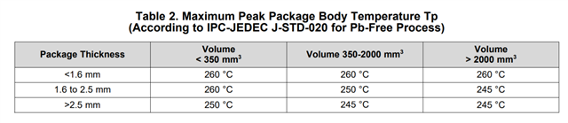

My customer reported soldering defect in item TMP112AIDRLR.
All of defect occurred in COO: China items but no defect in COO Thailand items. May I know why only COO China items have soldering defect?
 Is there any defect report reported from other customers for the below Lot?
China defect rate: 787pcs/1050pcs. around75%   (2130, 1310813JCE)
Thailand defect rate: 0pcs   (2132, 1801791HNA)
Please refer to the picture from the excel 211224 WA6-2304-000中国製 pw ca40.
Hence, we checked Lead finish/Ball material of both COO and found result as below.
Any reflow condition difference between these two Lead Frame Plating materials?
# reflow temperature at customer production is around 244.73℃
China: NIPDAU
Thailand: NIPDAUAG
We checked reference from TI website below and found both of the materials should be Pb-Free.
If that is correct, customer re-flow temperature did not over the standard. Why there will be such soldering defect on China goods?
