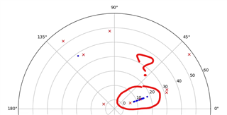

I am running 68xx Long Range People Detection with Tx Beamforming 100m configuration on IWR6843ISK. The radar return data show persistent point cloud in a line as shown below (blue points are the point cloud, red crosses are the detected targets). But there is no object in that area. I am supplying external power through TP12 TP13 pins on the radar PCB. Any idea what is causing this and how to fix it? I don't get any false positives if I switch to the 50m configuration.
