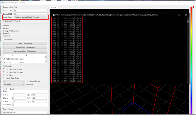

Recently, I'm using "overhead people counting" binary file to do human behavior research. After I used uniflash to load image, I execute mmWave_People_Counting_GUI.exe and choose "Overhead People Counting" as config type to see the result. The command always returns "read fail: not enough data", it seems that the device doesn't return any data. It would return the point clouds information if I choose "3D people counting" as config type. Also, I can't set the the parameters called profileCfg in cfg file. Since I want a higher resolution, the device stuck. All these problems shown as follow:
The command always displays "overhead people counting"
After I set new profilecfg, the device stuck.
By the way, I mount the sensor on the wall, just change the sensorPosition and boundaryBox commands in the CFG file to match. Is there any I should notice but I ignore, please mind me.

    So to use the overhead demo with the python gui, you will need to set the config type to "3D people counting" the older "legacy overhead" option is not the correct one. We will need to update that in the user guides thank you for helping us realize this and sorry for the inconvenience.
    Ensure that under Plot Controls the orientation is set to "Overhead Mount". Ensure the sensor position parameters also are set correctly in the configuration.
