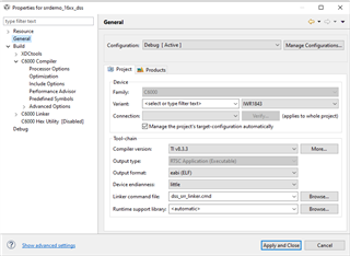

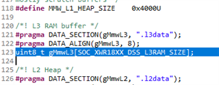

We have started migrating the DSS just updating any reference given on the Project properties menu from 16xx to 18xx, changing the variant to IWR1843, predefined symbols, linker, ... we based on Medium Range Radar example to change everything accordingly to the new device. We have also copy the "dss_mrr_linker.cmd" to "dss_srr_linker.cmd" (You can find attached). However, it throws the following error:
I think that it is something related to L3RAM size, because if I change this size:
to just something really small:
It compiles.

  • Hi everyone,
    I want to update my progress because I think that I found the main error, however continue without working well.
    I forgot to migrate the "c674x_linker.cmd" from mrrdemo_18xx_dss to srrdemo16xx_dss. Now I can keep the L3_RAM_SIZE as in the original example:
    However, as I said before the example is not working, when I open the "srr_visualization.exe" I do not see any data arriving. do I miss something more in the migration?

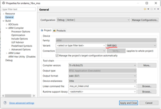

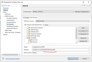

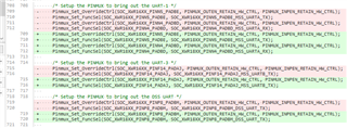

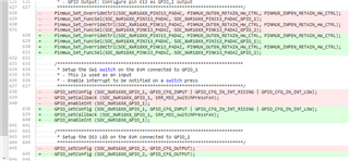

    I was able to migrate srrdemo_16xx_dss to 18xx device. But not in the case of ssrdemo_16xx_mss. When I run the debugger I see the following error:
    If I keep the ssrdemo_16xx_mss example as the original one, it works.
    The changes that I am doing in the MSS are the following:
    Also, I do not see any compiling warnings.
    Any ideas? do you think that I missing something?
    Thank you very much,
    Javier
