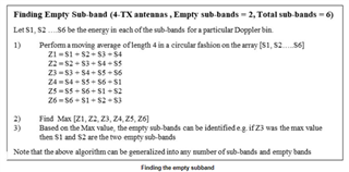

From the document ti/mmwave_mcuplus_sdk_04_02_00_02/mmwave_mcuplus_sdk_04_02_00_02/ti/datapath/dpc/dpu/dopplerprocDDMA/docs/doxygen/html/index.html.
We find that the doppler is selected from Z-value. If the velocity is negative, the maximum Z-value will be Z1, Z2 or Z3.
However, if the velocity is positive, the maximum Z-value will be Z4, Z5 or Z6 which will wrap the S1 to S3 value back from the spectrum.

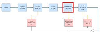

But the c code in C:\ti\mmwave_automotive_toolbox_3_6_0\labs\lab0015_high_end_corner_radar\src\datapath\dpc\dpu\dopplerprocDDMA\src\dopplerprochwaDDMA.c (line 1052-1151),
when calculate Z4, Z5, Z6, the value S1, S2, S3 are from the next chirp rather than wrapping back the same chirp S1,S2, S3 values. (Flow chart in red line block, DDMA Matric step)
I think without the wrapping back, it may cause the wrong positive velocity.

    I am going to have a discussion with the developer of the SDK datapath, which is in most part borrowed by the high end corner radar as well. It is my understanding that the shuffleMode being configured to HWA_SRC_SHUFFLE_AB_MODE_ADIM in the source configuration of the DDMA metric paramset should provide the wraparound needed to compute Z4, Z5, Z6. I will nonetheless confirm this.

    The wraparound in the shuffleMode is done after all chirps but the Z4, Z5, Z6 we need to compute are wraparound every 6 chirps (6 sub band for AWR2944). So i guess the mistake is caused by this wrong wraparound mechanism.

    This is what I mention before, if the velocity is negative, the maximum Z-value will be Z1, Z2 or Z3 which doesn't need wraparound and make results corrected.
    However, if the velocity is positive, the maximum Z-value will be Z4, Z5 or Z6 which need wraparound to get S1 to S3 value.
    And the wraparound in the shuffleMode is done after all chirps but the Z4, Z5, Z6 we need to compute are wraparound every 6 chirps. So I guess the mistake is due to  this wrong wraparound mechanism.

    Apologies for the delay. We were able to replicate, root cause and fix the issue. It will be fixed in the next release. The bug was in DPC_ObjDet_estimateXYZ function in ti\datapath\dpc\objectdetection\objdethwaDDMA\src\objectdetection.c. The HWA paramsets programmed did not have an issue with the wraparound.
