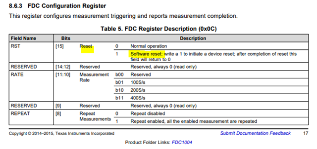

I found software reset function of FDC1004 at datasheet like below.
After writing a 1 to initiate a device, How long time will turn to changing reset bit to 0 take?
Thank you.
This timing isn't tested for this device but I measure roughly 2 milliseconds on my test setup using the EVM. The timing may vary but this should be a decent estimate.
