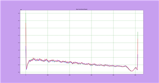

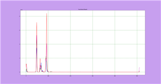

Hi, TI experts!
We have two custom cascade boards (AWR1243) . One is fully operational (reference board) but the other doesn't run Tx'es in my viewpoint.
Here are the R-profiles from operational board and nonfunctional for the same scene (frame configurations are same too). Second one looks like Tx'es are not run. But power consumption is equal for both boards.
We've seen that 20 GHz SYNC signal level is a little bit less for the non-functional board.
Can you suggest a possibble reason for such operating? Is there any AWR mode while there is a power consumption but there is no radiation?
Thank you

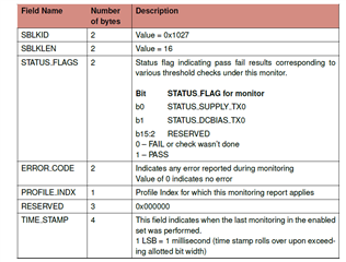

    We've got monitor reports for functional board and broken one. There is the only difference: please refer string 165
       AR12XX: MON: Tx0 Internal Analog Signal Report Status = 2 (broken board)
       AR12XX: MON: Tx0 Internal Analog Signal Report Status = 3 (functional board)
    From documentation:
    STATUS_SUPPLY_TXn         1 (functional board)               0 (broken board)
    STATUS_PWRDET_TXn       1 (functional board)               1 (broken board)
    But it isn't clear from documentation what does mean STATUS_SUPPLY_TXn  FAIL.  Can you clarify this please?

    The monitor API response details can be looked in to ICD(in DFP). The reported values from broken board report PS DAC failure. This is unexpected.

  • We use mmwave_dfp_01_02_00_00, so I guess this monitoring status is 2 bit, like this
    This statuses I've taken from DFP doxygen. Thanks for idea with CW tone, we'll try it.

  • Hi, Abdeh.
    We've done tests - Rxes are fine.
    Sorry, I don't understand about monitoring reports - we already made the comparison for functional and broken boards, I've wrote above the only difference:
    // in Interface Control Document  there is "STATUS_DCBIAS" instead of "STATUS_PWRDET_TXn".
    Can you, please, explain STATUS_SUPPLY_TXn parameter?
    Additional info on this matter:
    1) We've run board in a single chip mode and it operates correctly (both internal LO and looped back LO).
    2) In cascade mode with single chip in master mode with looped back LO no one Tx runs.
    3) Two chips in cascade recieve no signal too, picture is the same as for four chips.
    Guess the reason is in low power 20 GHz SYNC, doesn't it? Also please confirm that in single chip mode AWR is forced to use internal LO regardless of configuration parameters.
    Thank you
    Timur
      Good to know that.
    1. How did you confirm the RXs are fine? Did you generate a CW TX tone and RX it n broken board? Did you operate the device in single chip mode during this?
    2. When you say you operate the device in single chip mode did you only check primary or secondary device also? Were both working OK?
    1. We don't run CW mode, it not longer needed as we've recieved data completely coresponding to scene in single chip mode at any Rx while any Tx runs.
    2. We've only check primary device in single chip mode.
    But now I've update. PCB-manufacturer did not make a backdrill of vias on 20 GHz SYNC, we have backdrilled it on our own, and now all devices in cascade work properly.
    Thank you for your assistance!
    Timur
