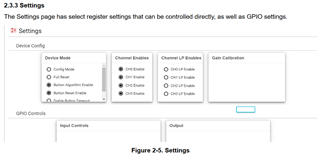

We just received a BOOST-LDC3114EVM and have successfully operated it through the PAM board using LDC3114EVM_GUI v.1.1.0. In the User's Guide (Rev Sep '21) there is a reference to a Settings page (section 2.3.5) with high-level controls for the EVM. This would be highly useful for us in our lab bench application. But this pane appears to be missing in the v. 1.1.0 GUI. Is this an intentional removal, or are we missing something in the GUI?

    Yes this section has been removed intentionally. A new user's guide revision documenting this will be released soon. If you are making register changes, it is recommended to do them through the registers tab of the GUI. The register tab has information about some of the register settings and breaks out the different control bits in the registers for easy use. Just make sure to put the device into config mode using the RESET register before changing register settings.
