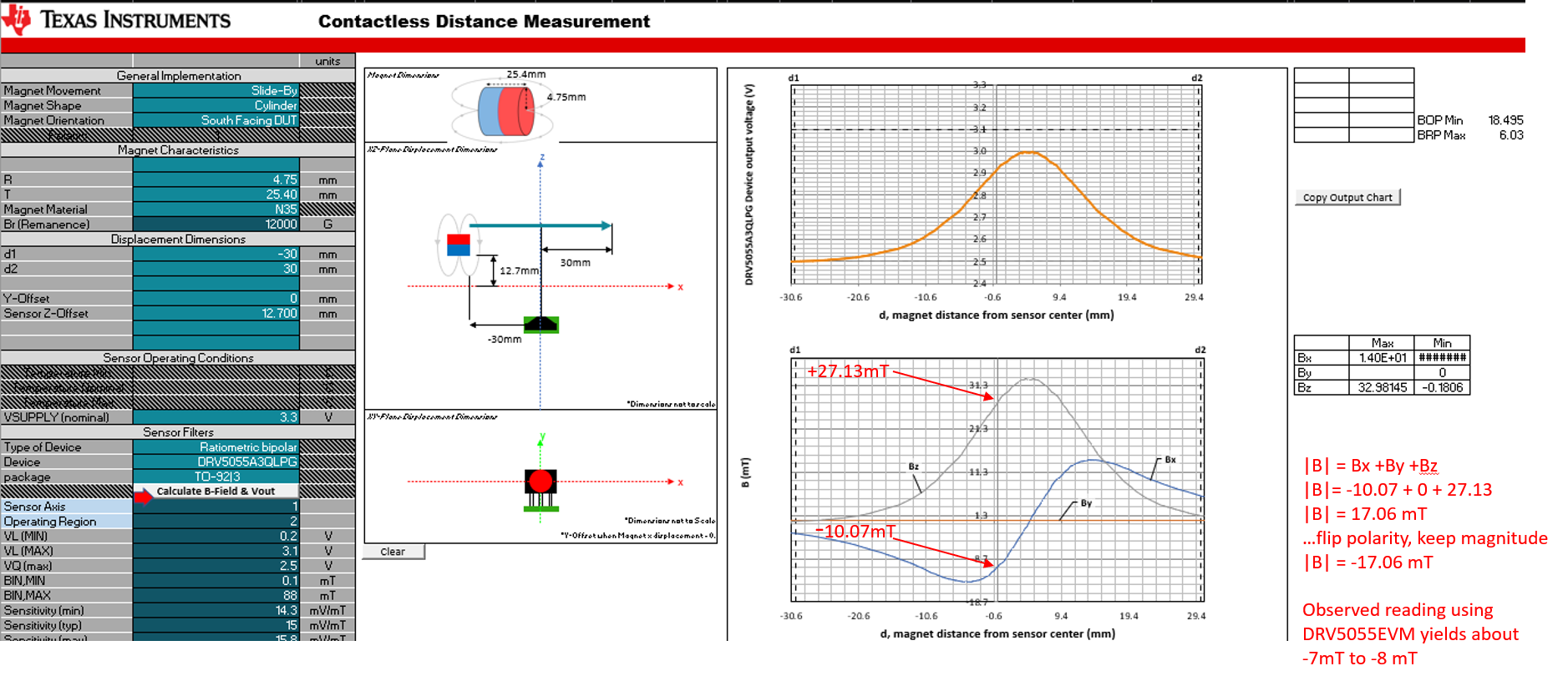

Have a few questions in regards to a TI calculator I am using,  Magnetic Sensing Proximity Tool. When I place the south side of the magnet facing the DUT (sliding from X =  -10mm to +10mm), the Z component (Bz) appears to read positive rather than negative (which I confirmed should be negative by using the DRV5055EVM I have in the lab).Also, the output voltage appears to be 2.5V instead of VCC/2 when at 0mT (also confirmed in lab using the DRV5055EVM). Am I missing something here? Specific part no is DRV5055A3QDBZR.
  • I have also tried changing the package type but get the same result. The TO-92 is what I’m testing with on the dev board, while the SOT-23 (DRV5055A3QDBZR) is what we are using. I ran the sim using bot South Facing DUT and North Facing DUT with same result. Also tried using Head On for Magnet Movement, using both North and South Facing DUT. Overall, the B field magnitude is still positive. Shouldn't the overall magnetic field magnitude (sum of the components) be negative?

  • Hi Christen,
    Thanks for the update. I tried testing again using the DRV5055EVM and the included N35 magnet as a reference. The magnitudes I see using the magnetic proximity tool vs the EVM are different still. See red annotation. annotation in pic below.

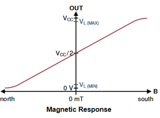

    For both TO-92 and SOT-23, the tool orients the device such that Bz corresponds to the Hall-element sensing direction. Based on the information provided and the device magnetic response (shown below), I would expect your device on the EVM to measure +7 to +8 mT when the South side is facing the DRV5055A3LPG.
    Additionally, when you measured your -8mT can you confirm that it was centered with respect to the Hall element situated at the origin of the x and y lines below?  If it was offset by a few mm you might get significantly different measurements.  Also does 4.75mm correspond to your magnet radius or diameter?
