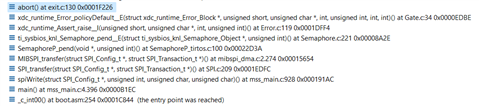

The chip returns an error when it gets to the semaphore pend with SPI_MODE_BLOCKING. My initial theory was that there was a different task blocking the SPI and both the SPI and that mystery task had the same level of priority

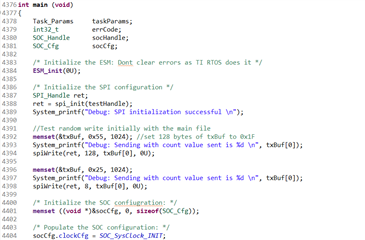

But then again, to try and confirm that theory, I took the spiWrite function out of my dedicated tasks (so other parts of the demo transmitted over UART) and called spiWrite early in my main function
This did not work and I got the same debug trace attached earlier.

    My spi_init function is attached below
    My spiWrite function is also attached below:
    While debugging, I noticed everything remains normal and the correct data is held in each variable.
    The debug crashes when I reach this segment of the code (attached below):
    A more detailed debug trace is this
    That's the error I have not figured out yet.

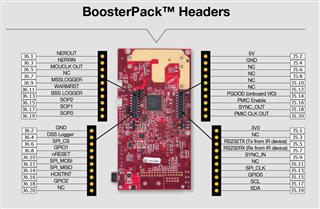

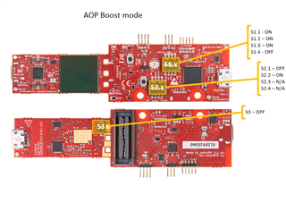

    1. After flashing the both sensors (IWR6843AOP EVMs) with the cssdebug image, we ensured to put them in the boost mode according to image below:
    2. The sensor are then placed on the MMWAVEICBOOST board which with the MUX for BP/LP mode (4th row) according to following image too:
    3. Using the guide from the boostcard pamphlet, we made connections for SPI pins at the jumper headers at the back of the boostcards:
    SPI-MOSI: J6:12
    SPI-MISO: J6:14
    SPI-CS: J6:6
    SPI-CLK: J5:13
    GND: J5:4
    Here also, the SPO was set at 001 according to:

  • Thanks for clarifying that, all those settings should be correct. Let's take a step back, and take your code and set the SPI slave to the default params (just comment out the specific params you set) and lets test to see what the behavior is there. The SPI driver is used by many other customers, so there must be something in the configuration/implementation here that we are not noticing. If it still errors with the default params, post any debug output information that it provides and we can go from there

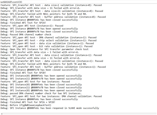

  • Hello Alec,

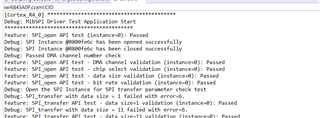

    I was able to connect both EVMs in their respective states with the default parameters from the SPI test.
    Debug information from the master device is shown:
    Debug information from the slave is attached below:

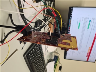

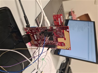

    For completeness, I also attach pictures of the setup:
    What else do you think I could look into? I don't notice any immediate errors except the slave getting stuck in an infinite loop due to supposedly receiving no information from the master.
    Could you please advice further?
    Thank you.

    It's a bit hard for me to tell for certain due to image quality, but it appears that the white jumper in your second photo is off by 1 pin in the 40 pin header, could you check this? Again, a bit hard for me to see, but I have edited your photo to show what I believe is your SPI_CLK plugged into J5.11 instead of J5.13
