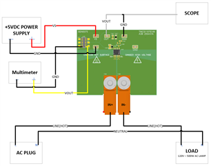

I am using the A3B (200mV/A) EVM and have connected an AC lamp as my load (See attached diagram for connections).
I am powering the EVM with a +5VDC power supply at VS but I am not seeing any change on the output side when measuring with a multimeter and I am getting what is to me odd results with a scope( See attached scope shots).

My Questions/Confusion:
  1. I thought the output should be a DC value, why do I see a sin wave with the scope -- this would imply to me that I'm seeing an AC signal?...
  2. Why are my multimeter readings the same with the load in ON state and OFF state? The lamp  is rated for 500W @120V, that's ~4Amps of current -- Using the A3B EVM, I should see at least an 800mV change with that much current, right?..
Am I doing something wrong or not understanding something completely?
Thanks in advance for any help!
  • Angelo,
       Thanks for considering TI product's in your application. To answer your question, consider that the bandwidth of the TMCS1107 is 80Khz. The 60Hz AC signal you are running through the input pins is easily tracked by the TMCS1107. It appears as an AC signal on the output. I assume your meter is set to read DCV. What's present on the output pin is actually an AC signal. When your meter is set to read DCV you are basically reading 0V or in this case mid supply.
       Going a bit deeper the first two scope shots are unexpected. The presence of any signal at all in the first two scope shots is a bit puzzling.  It seems that the device is going below ground and that’s not possible.  I suspect a scope coupling issue.  I’d set the scope coupling to DC.  This could be ground issues or residual voltage or current from the AC outlet.  I’d try the same setup but unplug the lamp from the AC outlet.

  • Hi Tommy,
    First, Thank you for your response.
    It turned out it was an issue with my DC power supply causing that noise (I believe it was a grounding issue with the supply). I reran the test and these were my results:
    • With all components OFF (NO POWER):
    • With ONLY the DC Power Supply ON(+5VDC) and load OFF:
    • With PS ON(+5VDC) and the load ON:
    Using the site that you provided, I used the formula below to calculate Vout,RMS(OFF) and Vout,RMS(ON).
    a0=RMS output offset value
    a1=peak voltage output @ offset
    I was able to calculate VoutRMS(OFF) as 2.541V by: VoutRMS(OFF)=sqrt(2.541^2 + 0^2/2)
    and I calculated VoutRMS(ON) as 2.67614V by : VoutRMS(ON)=sqrt(2.541^2 + 1.18750^2/2)
    I believe this is what I should expect from the EVM, is that correct?
