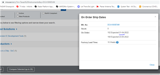

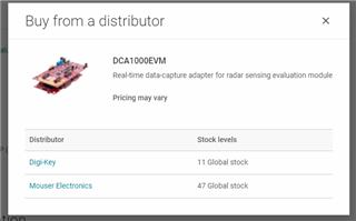

Hi, I'm using IWR1843 Boost board, I wanted to ask about the procedure of extracting raw data of the ADC.
1. Is there any way to do this with IWR board only without the use of DCA1000 or any other LVDS interface?
2. If not, then any cheaper alternative available for LVDS interface?
3. I was searching for an alternative, I found TSW1400 but mmWave-Devpack was also a requirement to use the TSW1400 board, but I found that mmWave-Devpack is obsolete. So any launchpad alternative available?
