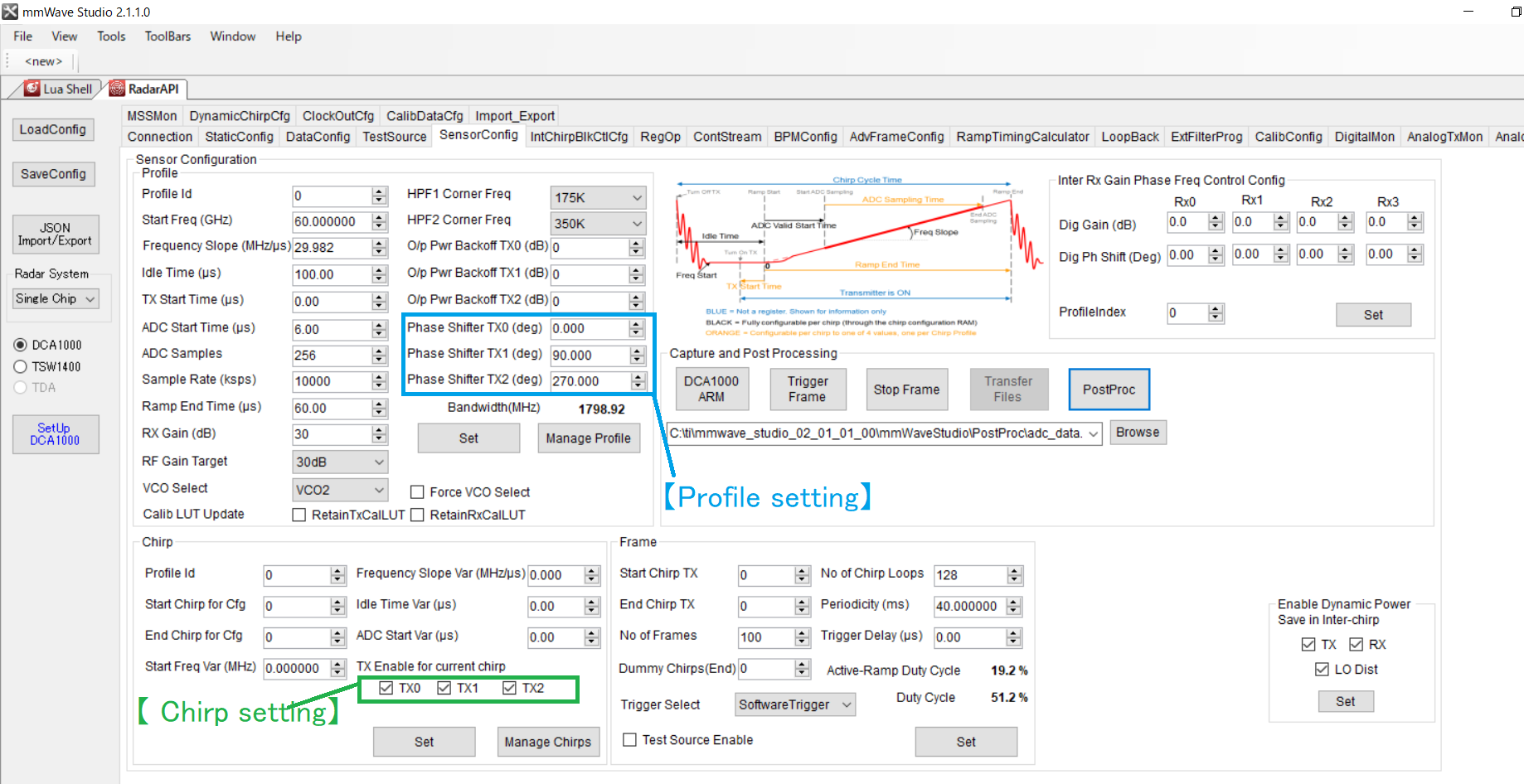

I started MMWAVE studio and became time out I triger start.
I seem to do TX channel config,There is TX0 by setting.
There are it which seems to have the function that ON/OFF performs of TX0,TX1,TX2 to mmWave module and the antenna for the transmission with TX1,TX2,TX3.
Look at the following attached figure.
TX0,TX1 and TX2 seems to set profile and chirp.
It is like the setting of TX1 ,TX2 and TX3 in another
User's Guide 60GHz mmWave Senser EVMs(swru 546d.pdf).
Look at the following attached figure.(User's Guide P.40)
When I make a transmitting antenna array, what is the function of TX0,TX1,TX2 in that of TX1,TX2,TX3 putting together?
