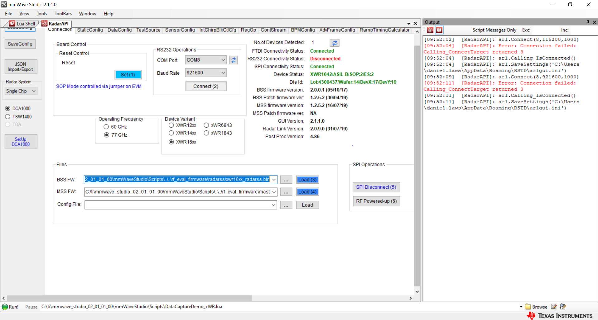

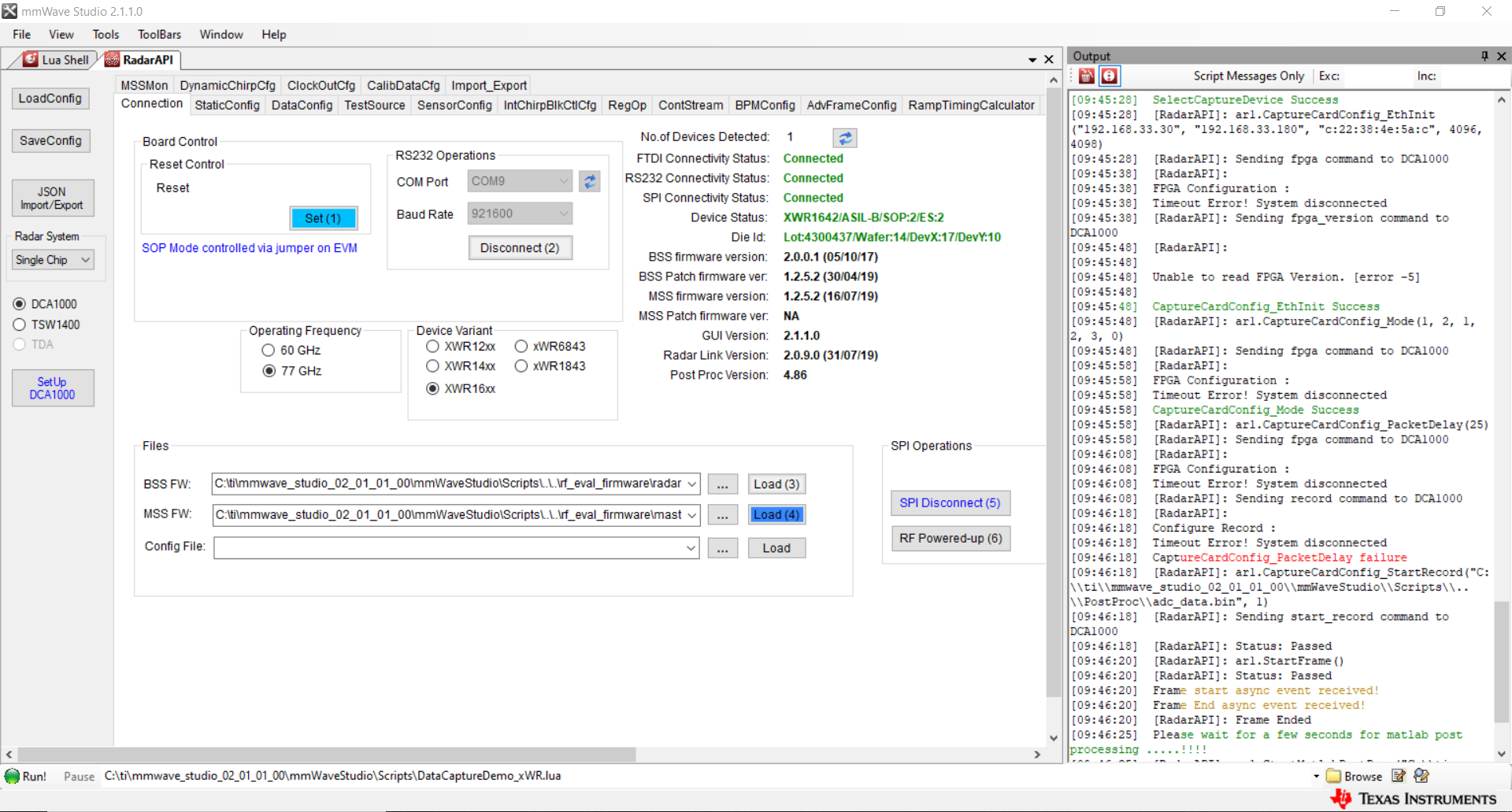

  • The following is about where I stand when trying to follow the quick start guide for using the DCA1000 with the AWR1642 in mmWave Studio as opposed to using mmWave Demo Visualizer:
    These are the settings I've tried in mmWave Studio. I get the same results when selecting a baud rate of 115200 .
    /resized-image/__size/1920x1031/__key/communityserver-discussions-components-files/1023/535543.Capture.PNG
    This is the full feed when I connect to the COM9 port (Application/User UART) with either baud rate and run the data capture demo script from the above picture:

    [09:45:28]  [RadarAPI]: ar1.CaptureCardConfig_EthInit("192.168.33.30", "192.168.33.180", "c:22:38:4e:5a:c", 4096, 4098)
    [09:45:28]  [RadarAPI]: Sending fpga command to DCA1000
    [09:45:38]  [RadarAPI]:
    [09:45:38]  FPGA Configuration :
    [09:45:38]  Timeout Error! System disconnected
    [09:45:38]  [RadarAPI]: Sending fpga_version command to DCA1000
    [09:45:48]  [RadarAPI]:
    [09:45:48]
    [09:45:48]  Unable to read FPGA Version. [error -5]
    [09:45:48]
    [09:45:48]  CaptureCardConfig_EthInit Success
    [09:45:48]  [RadarAPI]: ar1.CaptureCardConfig_Mode(1, 2, 1, 2, 3, 0)
    [09:45:48]  [RadarAPI]: Sending fpga command to DCA1000
    [09:45:58]  [RadarAPI]:
    [09:45:58]  FPGA Configuration :
    [09:45:58]  Timeout Error! System disconnected
    [09:45:58]  CaptureCardConfig_Mode Success
    [09:45:58]  [RadarAPI]: ar1.CaptureCardConfig_PacketDelay(25)
    [09:45:58]  [RadarAPI]: Sending fpga command to DCA1000
    [09:46:08]  [RadarAPI]:
    [09:46:08]  FPGA Configuration :
    [09:46:08]  Timeout Error! System disconnected
    [09:46:08]  [RadarAPI]: Sending record command to DCA1000
    [09:46:18]  [RadarAPI]:
    [09:46:18]  Configure Record :
    [09:46:18]  Timeout Error! System disconnected
    [09:46:18]  CaptureCardConfig_PacketDelay failure

    [09:46:25]  Please wait for a few seconds for matlab post processing .....!!!!
    [09:46:25]  [RadarAPI]: ar1.StartMatlabPostProc("C:\\ti\\mmwave_studio_02_01_01_00\\mmWaveStudio\\Scripts\\..\\PostProc\\adc_data.bin")
    [09:46:25]  [RadarAPI]: No of files Captured: 0, Total no of frames for each device : 8
    [09:46:25]  Error : The number of files captured is zero!
    [09:46:35]
    [09:46:35]  ***Script completed successfully.***
    These are the errors I get when attempting to connect to the COM8 (Auxiliary Data) port with either baud rate:
    [09:52:02]  [RadarAPI]: ar1.Connect(8,115200,1000)
    [09:52:04]  [RadarAPI]: Error: Connection failed: Calling_ConnectTarget returned 3
    [09:52:04]  [RadarAPI]: ar1.Calling_IsConnected()
    [09:52:04]  [RadarAPI]: ar1.SaveSettings('C:\Users\daniel.laws\AppData\Roaming\RSTD\ar1gui.ini')
    [09:52:09]  [RadarAPI]: ar1.Connect(8,921600,1000)
    [09:52:11]  [RadarAPI]: Error: Connection failed: Calling_ConnectTarget returned 3
    [09:52:11]  [RadarAPI]: ar1.Calling_IsConnected()
    [09:52:11]  [RadarAPI]: ar1.SaveSettings('C:\Users\daniel.laws\AppData\Roaming\RSTD\ar1gui.ini')
    The settings and window I see when doing the above:
