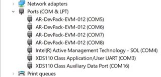

Hi Experts,
Good day.
Client is working with the AWR1843BOOST with DCA1000.
When they try to connect SPI by selecting the 'SPI Connect tab', they're getting an error as shown in the attachment.
They did go through the other solutions provided on the Sensor forum and have checked for the following:
1. Switch S2 on the EVM is set to 'SPI'.
2. Static IP address has been set.
3. The SOP switches are set to the configuration (SOP0 = ON, SOP1 = ON, SOP2 = OFF).
4. The BSS and MSS files selected are correct.
Any solution on this?
Thanks ahead for your assistance.
