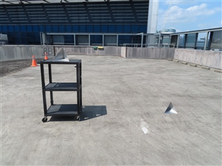

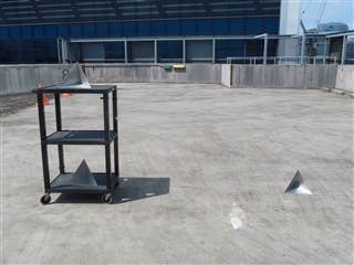

The distance to the target was approximately 20m.  In order to test the vertical discrimination of the target, 2 tests were done. The first is shown below. The distance between CRs (lengthwise) is approx 2.5m.
(setup 1)
The second test (setup 2) is by adding a 2nd CR at the bottom of the cart as shown below: The CRs have approximately a distance of 1m (height-wise) between them.

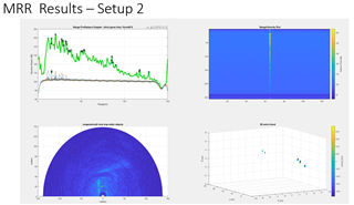

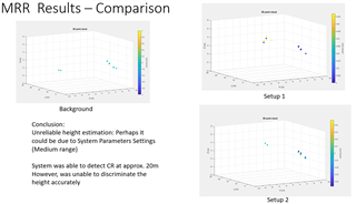

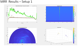

I've run Matlab sample code cascade-MIMO_signalProcessing (note that I am using the default calibration file, i.e. no calibration was done). Although the range profile did show a return for both test setups at the correct distance,  it seems that the height discrimination was not effective (by viewing the 3dpoint cloud) whatsoever. (Note that the Axis of the 3d point cloud were limited in order to filter out any unwanted dots)
By using the 3d point cloud, I was not able to really decern any height discrimination. (note that the background capture in MRR-Results Comparison was taken without any CRs present. just the cart itself)

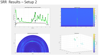

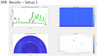

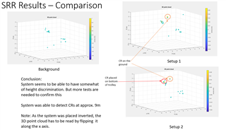

The second test (SRR Parameters), was performed in the exact same way with only 2 differences.
1. The CRs were at a much closer distance to the system (approx 9m.) i.e distance from the system to target was approx 9m.
2. The CRs were placed closer together (lengthwise), approx 1.5m
However this time, there was some height discrimination.

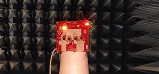

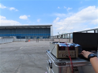

As the System was placed inverted,  (something like this)
I've noticed that the 3D point cloud has to be read by flipping it along the x-axis.

     If the two objects are in the same range-Doppler-azimuth bin then the height discrimination capability of the system is dependent on the virtual array aperture in the elevation direction and is not dependent on the chirp parameters such as sampling rate, chirp slope, start frequency etc. If all the TX channels along the elevation direction in the cascade board EVM are used then theoretical elevation angle resolution is ~ 18 degrees. This angle resolution in degrees is independent of the radial distance of the object from the sensor.
    In the experimental setup that you have described i.e. 20 m radial distance and separation of 1 m between the corner reflectors, the angle separation of the two corner reflectors is roughly ~  2.9 degrees (based on basic geometry). Note that this is less than the elevation angle resolution of the system (i.e. 18 deg), hence you would not be able to discriminate between the two corner reflectors. This is consistent with what you are observing in your experiments
