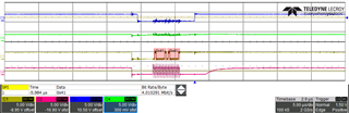

Hello, I am trying to configure the  TDC1 of TDC7201 on the ZAX EVM Board with STM32F334 controller via SPI protocol.
I believe i have configured everything as explained in the Datasheet. I am still receiving 0x00 from the registers i wrote to.
Does anyone have any idea why this is happening?

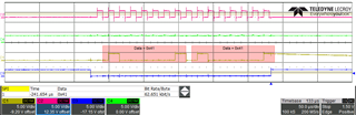

Image 1: Master Out Slave In (MOSI:Green, SCLK: Pink, Chip Select: Blue)
Image 2: Master In Slave Out (MISO:Green, SCLK: Pink, Chip Select: Blue)
    Welcome to the E2E forum.
    Can you please share a capture for the CSBx, SCLK, DIN, and DOUTx while you execute the code?
    This will help me more easily compare your results to the expected result.

  • Added screenshots to my original post.
    I ran your commands on my EVM and captured the SPI communication data:
    Green: DIN, Pink: SCLK, Blue: CS, Yellow: Dout.
    Writing to address 01h, value: 041h
    Reading address 01h, return value 041h
    It looks like our waveforms are identical in data, however I am concerned the noise observed on some of your traces may be influencing the SPI communication.

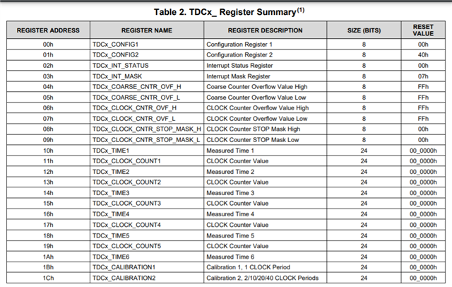

    Have you attempted to read any other register values yet?
    If not, please try to read register address 03h or 04h. These registers will have data within them from factory. I would like to see if this issue is exists on both the read and write cycles.

    I tried reading registers 03 and 04 and i still see 0.

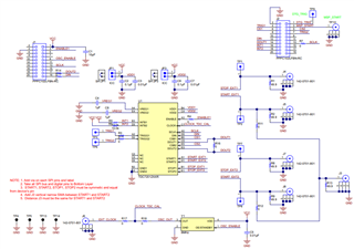

    We have an EVM schematic in the TDC7201 EVM User's Guide, this may help us debug if any hardware issues exist for your setup.
    The VCC pin can be connected to a 3.3V rail, as the enable pin is the only pin you need to sequence. Startup requires the enable pin be transitioned low to high sometime after the device has supply.

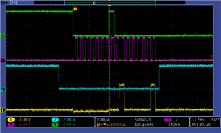

  • Yes both jumpers are populated on the EVM board.
    Somehow, the signal level from DOUT1 line from TDC going into ST Eval board does not seem very reasonable. This line is configured as an Input.
    Clock from Master (Red) MOSI (Yellow); and CS (Blue) line make sense.

  • Hello Jacob,
    I tried reducing the clock Rate to 62.5KHz. This is the most stable (less noisy) voltage levels i could obtain. I was not able to get rid of the transients entirely. Clock , MOSI and CS lines are at 3.6V . Is this too high for the TDC board?
  • Hi Abel,
    3.6V may be tolerable depending on the supply voltage to the TDC board.
    If the supply is 3.3V, then 3.6V input is at the ABS max condition limit, and outside the recommended operating range:
    Exceeding ABS max conditions can cause permanent damage to the device. Exceeding recommended operating conditions for extended periods of time can also influence device reliability.
     The voltage levels look more stable in this scope shot compared to the previous setup.

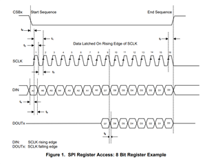

    I think I may have found the culprit to the issue you have been encountering.
    Data is latched on the rising edge of SCLK for the TDC7201, and in your waveforms, the data lines are changing states while SCLK is rising.
    See below for the access example:
    Please change the phase offset of the SCLK line, and let me know if this helps get the device working.
    Jacob
