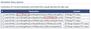

What does numTXPatterns in Radar Cube mean?
       numTxPatterns refer to the the number of TX antennas in the snip you have shown. You could probably refer to MMWAKES SDK doxygen:file:///C:/ti/mmwave_mcuplus_sdk_04_02_00_01/mmwave_mcuplus_sdk_04_02_00_01/ti/datapath/dpu/rangeproc/docs/doxygen/html/dpu_rangehwa.html to understand better.
       Let me know if you have any questions.
