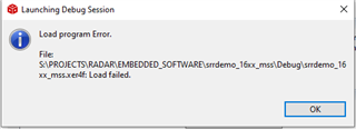

    I add screenshots to show current status.
    Here is the error I get when debug fails.
    ERROR

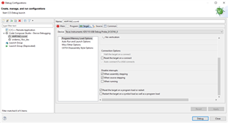

    Here is the mss and dss debug configs
    Please check and give me a feedback.

  • Have you tried loading the mmWave SDK demo pre-built binaries provided in:
    C:\ti\mmwave_sdk_03_05_00_04\packages\ti\demo\xwr16xx\mmw\xwr16xx_mmw_demo_mss.xer4f
    Thank you
    cesar

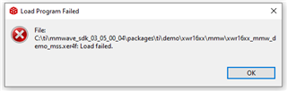

  • Hi Cesar,
    I follow the manual debug steps.here is the screenshots.
    first I go to "target configurations" and  "launch selected configuration" then the debug log is this
    then connect both cores
    then load program to dss and it is succesfully enter main function
    then load program to Mss But MSS core gives error.I also try to load program to MSS first but it gives error again.
    Here is the error logs.
