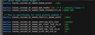

Prerequisites: after configuring a profile on TDA2x platform and setting the sampling point to 512, I found during simulation debugging that the currentProfile obtained was not 0, and there was random jump, for example, currentProfile value was 5,7,52, etc

  • thank U very much.First,I found  currentProfile is error in debug mode with CCS. both appear in DSP core and IPU core.Second, I only changed chains_common_cascade_ar12xx_config_bf.c in usecase of cascade_radar_beam_form.c the following pictures are may change.
    Please help me check what I should do.
