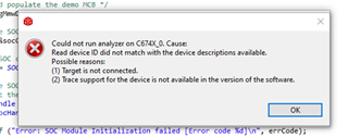

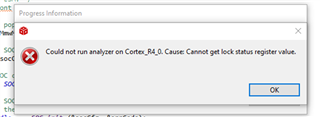

I have a question about the PC Trace Analyzer.
Is it possible to use the PC Trace Analyzer.
I always get an error message. ID not found. What am I doing wrong?
I use the following components: IWR6843ISK, MMWave IC Booster (XDS110), CCS v10.
Gerhard
  • Hi Alec,
    I have read the thread and tried many things, but I had no success.
    I kept getting the following error messages.
    As described in the thread, it is possible to get PC-Trades from DSP C674X. I didn't succeed there.
    Unfortunately, many settings are not visible, such as the target configuration, initialization script xxx.gel, etc.
    I hope you can give me more information.
    Gerhard

  • Hello Alex,
    I know the document.
    What I don't understand is that the RTOS Analyzer -> Exection Analyzer works for me.
    See the following pictures.
    Only the hardware trace analyzer does not work!
    With the error as above in the  thread.
    Attached is the mss_mmw.cfg file.
    Perhaps the error is here? Can you help me ?
    Kind regards Gerhard

  • Hello Alec,
    I am using the IWR6843ISK with mmWave IC Booster (XDS110), CCS v10.
    I flash the IWR6843ISK with the ccsdebug.bin file using Uniflasher.
    Then I connect CCSv10 to the IWR68431ISK and start the debug.
    See PDF attachment for instructions.
    Then I start the High_Accuracy_Visualizer 1.2.0 to send the .cfg data.
    Best regards
    Gerhard
    Using CCS Debug for Development.pdf
  • Gerhard,
    Just to be clear, the demo functions properly and you are able to debug it normally, and everything works as expected until you try to use the trace tool, correct?
    Alec
  • Hello Alec,
    yes, right.
    Best Regards
    Gerhard
  • Gerhard,
    I have done some testing on my side and see similar behavior to what you have seen. I definitely believe the issue is related to the GEL files utilized by the target configuration, but i'm afraid that I do not have much additional insight to provide since support for this tool has been discontinued for a couple of years now. Based on feedback provided in the other thread that we previously discussed, I believe this to be possible, but in that instance the user found the resolution themselves and did not share it on the forums. Let me know if you make any progress or have any other questions related to the device.
