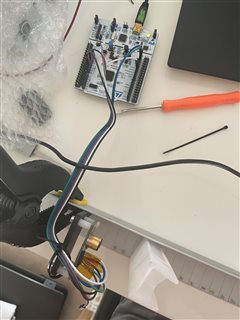

I am using the SDK with the first time bring up procedure.
Despite using the cache and set distance phase offset measurements, a strong off set appears due to the switching of the illumination DAC to high/low value.
I am running the first time bringup with receiving diode cover, then 10mm and 20mm phase offset calibration.
Depending on the situations, I am getting around 300 up to 14000 unit phase offsets when the ADC switches currents.
If you see a mistake in my mode of operation I would be very grateful to get feedback from you,

  • Hi Alex,
    thank you for your prompt reply,
    You will see attached the data I got:
    I was  measuring steps of 20mm from 10mm to 450mm.
    I am using the SDK with my own MCU.
    The application is meant for medium distance ranging of the size of a thumb.
    Best regards.

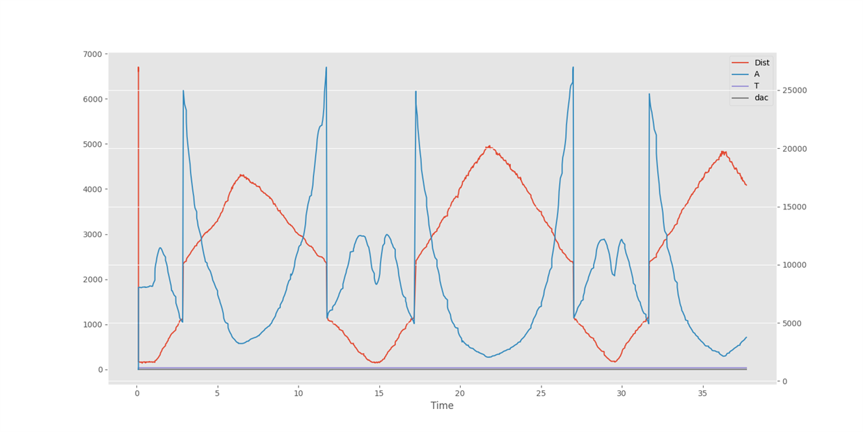

  • Hi Thomas,
    Can you share amplitude as well?
    Alex
  • Hi Alex,
    Here is the corresponding amplitude for the session :
    Thomas

  • Hi Thomas,
    It is still tough to tell what is happening. Can you share the raw data files (should have phase, distance, temp, amplitude, as well as HDR setting of device). Also what are you doing in this test? Can you give picture and description of steps in the test setup and data collection?
    Alex
  • Hi again Alex,
    Here is a data sample:
    As you will see when i move away the targetted object (a thumb sized bloc) the amplitude diminishes to the threshold level where the hdr starts to use a higher illumination current, this brings the a bit amplitude higher as the emitter goes stronger.
    My problem is that in my opinion, something is missing in my firmware to enable the phase offset compensation, and leaves a strong phase offset in the result.
    I will share with you the settings I used asap

    I'm taking a look at this and I should have an answer for you early next week.
    Thank you,
    Brent Elliott
  • Hi Brent,
    To complete my previous answer to Alex, I am using the i2c interface and going through this procedure .
    (at initialization) dev.calibrationSession_firstTimeBringUp();
    (every 100ms) dev.liveDataView(1, dev.configurationFlags_frameTimeInMilliSeconds, true);
    Thanks for the help.
    Thomas Perraton
  • Hi Thomas,
    Do you have a picture of your setup with the target you are calibrating with? It might be good to start with a larger target to calibrate to see if field of view of the emitter is affecting the calibration. Could you also send me data above including the HDR mode values? Also, you have negative values in the "mm" column of your data. Which column is the actual distance and which is the device measured distance?
    Thank you,
    Brent Elliott
  • Hi Elliot,
    Thanks your for the help and sorry for  the late reply.
    You can find attached a picture of the setup. I am using the I2C interface with the OPT3101EVM pins, as a prototype.
    Concerning the negative results you rightfully pointed it is a relicate from a previous work that I did not mean to send you, sorry for this. Here are more data of an attempt I made with the following settings :
    this->reg.hdr_thr_high = 27000; // //High Threshold
        this->reg.hdr_thr_low = 5000;    // //Low Threshold
        this->reg.en_adaptive_hdr = 1;    // //Enables adaptive HDR feature
    this->reg.illum_dac_h_tx0 = 10;     // //High Current settings [173.6mA:5.6mA X 31]
        this->reg.illum_scale_h_tx0 = 0; // //Illum scale for H [173.6mA:5.6mA X 31]
        this->reg.illum_dac_l_tx0 = 10;     // //High Current settings [043.4mA:1.4mA X 31]
        this->reg.illum_scale_l_tx0 = 3; // 3 ;// //Illum scale for H [043.4mA:1.4mA X 31]
    Data.csv

    Sorry, I realize the previous data are difficult to interpret as the offset is taking all the space.
    I gave you extra data here:
    You will notice the offset is milder here, I think it is because I reduced the DAC current. (176mA->40mA)
    0513.Data.csv
    For the test, I moved the target from 20mm to 300-350mm from the sensor, by coming back and forth.
    You will see that the distance is rising then falling in the blue chart.
    In red, the amplitude also rise and falls accordingly with the proximity of the target (my hand in this scenario) it triggers or deactivate the HDR, which causes the sharp changes in amplitude.
    You will also notice that instead of having a perfect triangular profile for the distance, a strong non-linearity occurs on the HDR switching.
