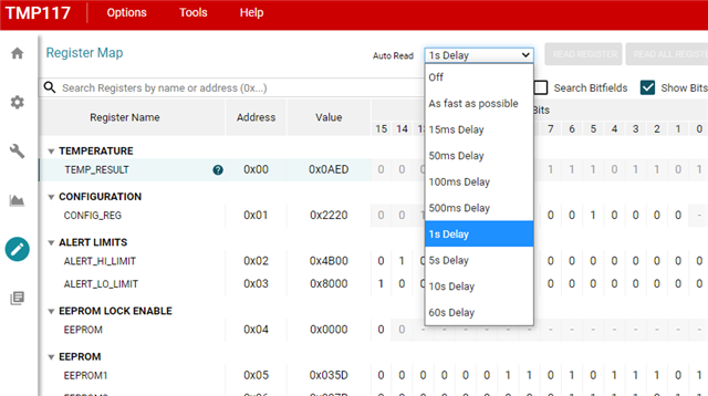

IN GUI, they set Register Auto Read Delay to 1s ;

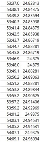

and they got a log as below ;
as you see, to 53:51:2, it sampled every a second, but after that it sampled every about 2 second.
is it normal operation? or should we set other settings if we want to get samples per every second?
