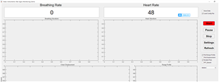

单板连接后显示如下:
程序烧录后,用GUI去查看数据
无数据,请问:我没有MMWAVEICBOOST,只有IWR6843AOPEVM这块板子,如何解决这个问题

The 68xx Vital Signs demo needs to be run with a MMWAVEICBOOST board attached to the AOP. For a standalone vital signs demo that works with IWR6843AOP please see 3D people counting with vital signs.
Thank you,
Angie Mitchell
A standalone vital signs demo that works with IWR6843AOP is 3D people counting with vital signs. The binary for this lab which will work on the IWR6843AOP in standalone mode can be found here if you download the toolbox.
However, the source code for that lab is not available to the public, for access to this please talk to your TI sales representative.
