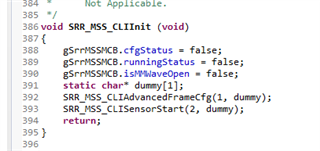

Ok, by this way I can program an auto start functionality. Therefore, I think that I do not need to use the UART for that purpose and Can I use it for other things, no? However, If I call to "SRR_MSS_CLIAdvancedFrameCfg" and "SRR_MSS_CLISensorStart" without calling to "SRR_MSS_CLIInit" and consequently without opening the Client using "CLI_open", the program fails when it tries to open the mmWave module through "MMWave_open".
Therefore, what is really doing the Client? Why it needs to control the mmWave module? I am not understanding it well and I thought that the Client was only a kind of Client UART manager which process the commands. Can I remove all the UART implementation and only keep the mmWave module configuration? Something like this:

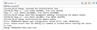

    As you said and as I said in the first post, the MRR (Medium Range Radar demo) does not need the UART for the configuration. However, if you remove all the code related to the UART in the SRR example and you keep the CLI_init function like this:
    You will receive the following error:

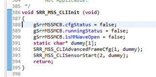

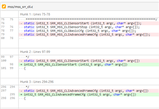

    However, if you transform SRR_MSS_CLIAdvancedFrameCfg and SRR_MSS_CLISensorStart to extern functions like this:
    It works!! Therefore, there is some dependency that I do not really understand. Could you explain me why is working if you make that functions extern?

    Most of our demos are based on the mmWave SDK demo. This demo uses the CLI commands infrastructure to provide flexibility for configuring the demo. This feature is desirable for a general purpose demo.
    The srr/mrr demo was based on an early version of the mmWave SDK demo. In the srr/mrr demo in order to reduce program memory consumption, the configuration was hard coded. However the cli infrastructure is still present in the code.
