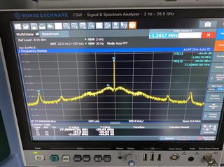

We use 40MHz  TCXO ( KDS DSB321SDN  ) to replace XO to avoid AWR2243 Device Errata ANA#18B Spurs Caused due to Digital Activity Coupling to XTAL.

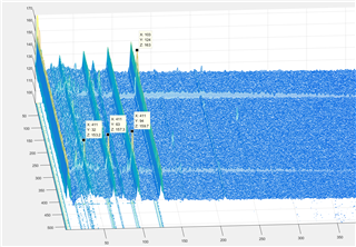

But there is spurs about 1.2MHZ with TXCO,we can notice the spurs on the RD image.And it`s clear with XO.

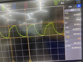

We have checked TCXO Vcc ripple.and it is clean.
the below picture shows wave form of TCXO.and the Vp-p is about 0.93V
Do you have  any ssuggestion ?

  • Hello ,
    While using the TCXO have you pulled the XTAL_M pin to Gnd? Is there any 1.2Mhz clock in the system? like is the power supply a switching regulator with 1.2Mhz switching freqeuncy?
    Vivek

  • Hello Xu,
    We have tested the TCXO mode by feeding the clock from an external equipment. I would like to understand the reason you suspect the TCXO operation. Do you have another replica of the HW using the xtal where you dont see the issue?  Or have you fed external clock from an equipment instead of TCXO to see if the issue goes away?

    Do you mean on the same board you have option to use TCXO or XTAL and XTAL does not show the spur? In that case the TCXO clk itself might have the spur. Have you measured the phase noise of the TCXO o/p ? You could feed 40Mhz sin/square wave using external equipment also and see if the spur changes.
    regards,
    Vivek
