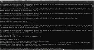

I am following the instructions in the User Guide in order to flash the ccsdebug image, but flashing process fails.
I have updated the setenv.bat to use awr2944, using the right folders, debug.cfg file, User/Application COM port, UART boot mode.
But when running the final python script I am getting below message after some time ... not seeing anything on the load progress bar.
Using the exact same steps but for AM273x EVM it is working fine and I am able to load the ccsdebug image.
Am I missing something? Any hints are welcome.

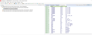

    3. Below is the address when connecting with CCS to R5_0
    > 0x00004276
    Thanks and best regards,
    Gregor
  • Hi Gregor,
                   Okay we see that, the sbl uniflash uart is not getting uploaded and from your screenshot and address its very clear. So can you please try with another pair of jumpers in 101(SOP 5) mode. I do remember I had faced this problem initially when the jumpers were not setting in SOP 5 mode correctly.
                   Let me know if you have any questions.
    Thanks and Regards,
    Akshay.
  • Hi Gregor,
    Could you also reply with the value of the register MSS_CTRL:R5_ROM_ECLIPSE @0x02120804?
    I want to see if the ROM is being eclipsed or not. If the UART boot mode is latched correctly, the ROM should not be getting eclipsed before sbl_uart_uniflash is sent. If the device is still somehow in QSPI boot mode (possibly faulty jumpers), the ROM would be eclipsed.
    Aayush
  • Hi Aaayush,
    I have tried with different jumpers, but same behavior.
    Below is the register value: 0x00000000
    Gregor
  • Gregor,
               Thanks for sharing the screenshot. It seems ROM eclipsing has not happened and there is the issue with jumpers as its not set to SOP mode 5 correctly. I am closing this ticket for now.
