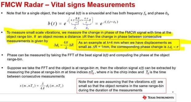

In the example of Vital Signs, if the customer wants to obtain the amplitude of respiration and heartbeat, which of the following parameters should be output in the structure of VitalSigns_Output? Is the unit of this parameter in mm?
 1.outputFilterBreathOut
 2.outputFilterHeartOut
 3.sumEnergyBreathWfm
 4.sumEnergyHeartWfm

  • Hi Nancy,
    I have an update.
    The below two fields in the UART stream are the outputs after the bandpass filter that is used to separate the breathing and heart-beat waveforms.
    These values are obtained by scaling the output values from the bandpass filter by lambda/4pi as shown above.
    However, these values are "arbitrary unit (a.u.)" rather than mm.
    There are several pre-processing steps (i.e. phase difference, IIR filtering) performed on the phase values which will impact the amplitude of the waveform. For example, if the values are at the stop band region of the IIR filter, the filter would attenuate the amplitude of the signal but obviously the actual physical chest displacement is not decreased.
    To obtain accurate physical displacement some calibration/scaling would be required which is not implemented in the current demo.
