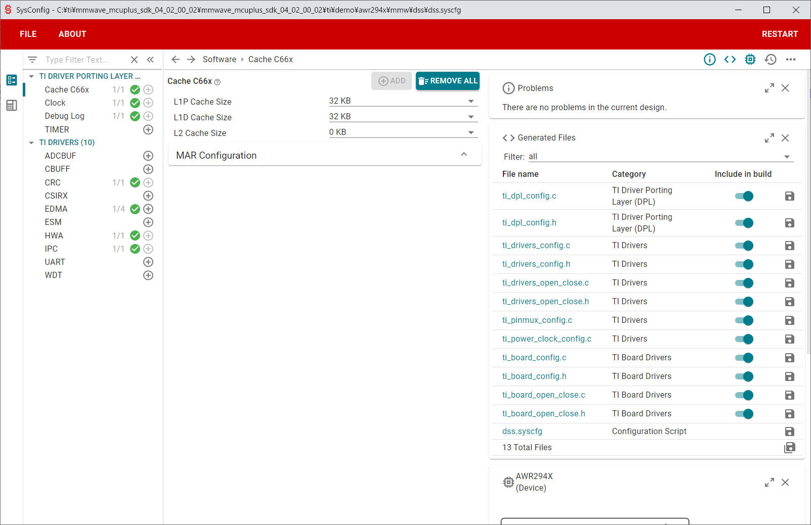

  • Hi Mr. Daisuke,
                            To open the syscfg files of demo. I would request you to please select: TI SysConfig (shortcut) available at C:\ti\mmwave_mcuplus_sdk_04_02_00_02\sysconfig_1.10.0. This opens up a dialog box of SysConfig.
                              From this window select browse and select dss.syscfg available at C:\ti\mmwave_mcuplus_sdk_04_02_00_02\mmwave_mcuplus_sdk_04_02_00_02\ti\demo\awr294x\mmw\dss\dss.syscfg. You should have been able to open dss.syscfg using this procedure. Let me know if you have faced any issues here (because its working fine for me).
                              For mss.syscfg I had faced some issues as mentioned by you. So there is a temporary fix you could follow for this. In mss.syscfg replace the file header comments as shown below in green colour:
                             Also, remove/delete the lines of code highlighted in red below:
                             Then you should follow the same procedure as mentioned (similar to dss.syscfg) for opening the mss.syscfg file.
                              Let me know if you still face issues or you have doubts regarding this.
    Thanks and Regards,
    Akshay.

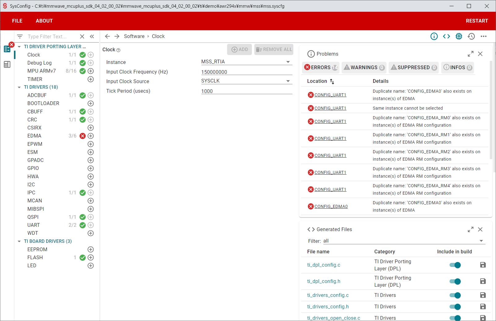

  • Hi Akshay-san,
    Thank you for your reply.
    The dss.syscfg cannot be opened with the procedure you said.
    The mss.syscfg cannot be opened even with the changes you said.
    Attached is the modified mss.syscfg file:

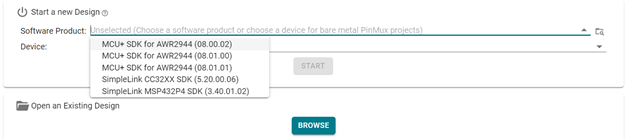

  • Hi Daisuke-san,
    I could open the mss.syscfg you had shared on my end. Could you post a screenshot of the home page dropdown menu in sysconfig? It should look something like this:
    As a workaround, there is also an alternative way to open up syscfg files from the GUI by using the following CLI command:
    C:/ti/sysconfig_1.10.0/nw/nw C:/ti/sysconfig_1.10.0 --product C:/ti/mmwave_mcuplus_sdk_04_02_00_01/mcu_plus_sdk_awr294x_08_01_00_34/.metadata/product.json --device AWR294X --context r5fss0-0 --part Default --package ETS --output generated/  <syscfg_file_path_name.syscfg>
    Could you try using this and see it it works?
    Aayush
  • Hi Aayush-san,
    Attached is a screenshot of the dropdown menu in the SysConfig tool.
    The workaround you indicated worked fine.
    C:/ti/mmwave_mcuplus_sdk_04_02_00_02/sysconfig_1.10.0/nw/nw C:/ti/mmwave_mcuplus_sdk_04_02_00_02/sysconfig_1.10.0 --product C:/ti/mmwave_mcuplus_sdk_04_02_00_02/mcu_plus_sdk_awr294x_08_01_01_06/.metadata/product.json --device AWR294X --context r5fss0-0 --part Default --package ETS --output generated/ C:/ti/mmwave_mcuplus_sdk_04_02_00_02/mmwave_mcuplus_sdk_04_02_00_02/ti/demo/awr294x/mmw/mss/mss.syscfg
    C:/ti/mmwave_mcuplus_sdk_04_02_00_02/sysconfig_1.10.0/nw/nw C:/ti/mmwave_mcuplus_sdk_04_02_00_02/sysconfig_1.10.0 --product C:/ti/mmwave_mcuplus_sdk_04_02_00_02/mcu_plus_sdk_awr294x_08_01_01_06/.metadata/product.json --device AWR294X --context c66ss0 --part Default --package ETS --output generated/ C:/ti/mmwave_mcuplus_sdk_04_02_00_02/mmwave_mcuplus_sdk_04_02_00_02/ti/demo/awr294x/mmw/dss/dss.syscfg
    Daisuke

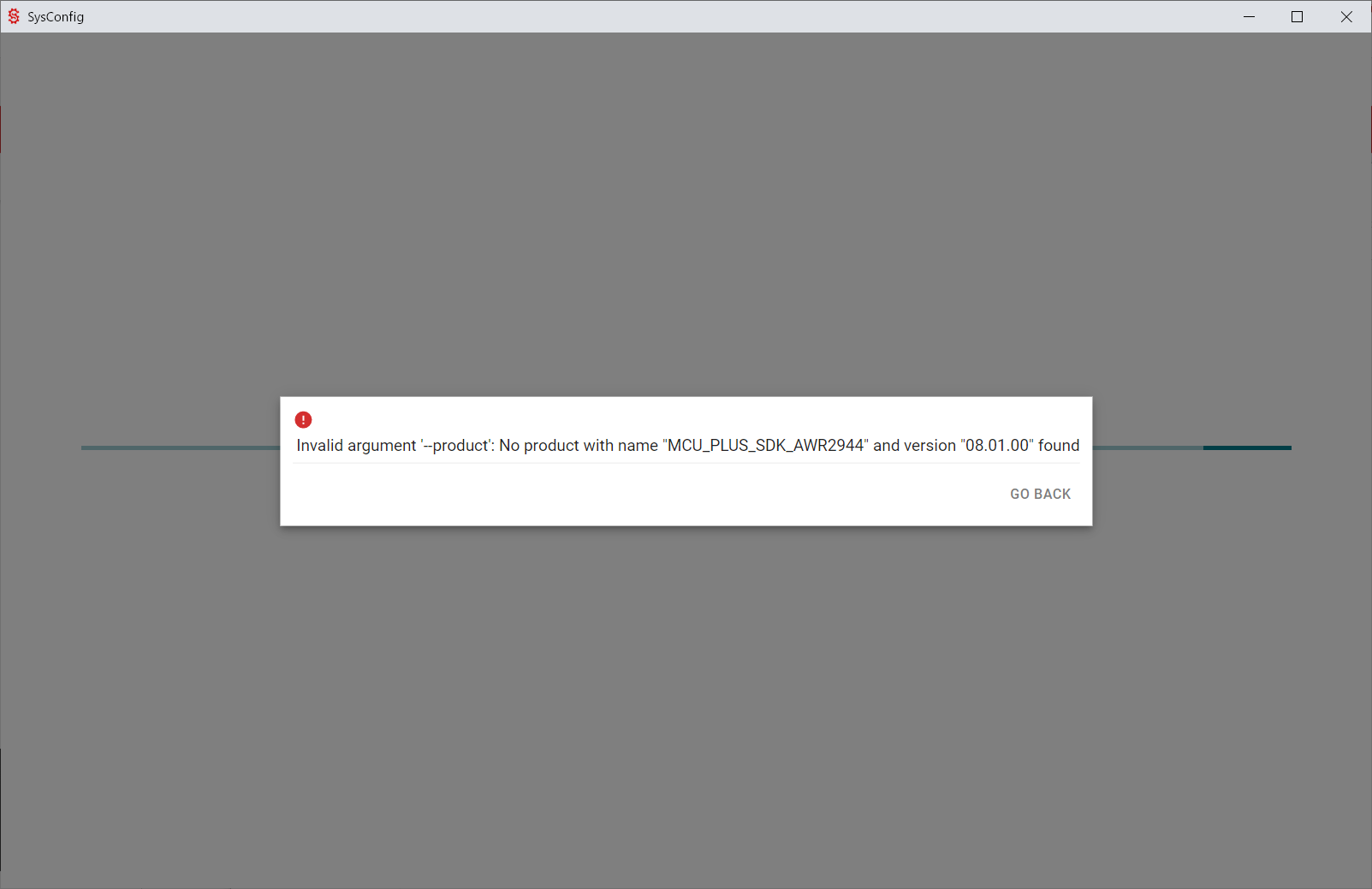

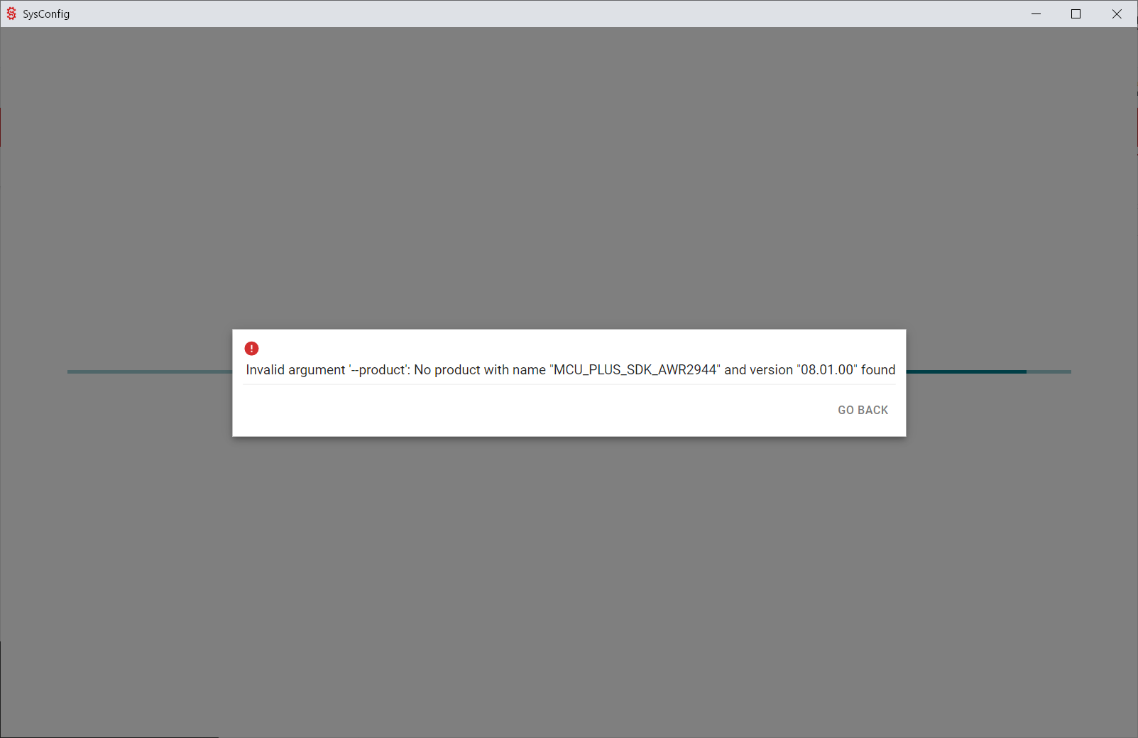

  • Hi Daisuke-san,
                            Thanks for confirmation that workaround suggested by Aayush worked. Can you please let me know if this ticket can be closed if your query is resolved?
    Akshay.
  • Hi Akshay-san,
    It would be preferable to open the SysConfig files on the GUI of the SysConfig tool, but that was also resolved by another thread suggestion for AM2732.
    e2e.ti.com/.../am2732-sysconfig-file-cannot-be-opened-on-sysconfig-tool
    It seems that the argument for MCU+ SDK in the header part in the SysConfig file is required to contain the corresponding device name and software version.
    For mss.syscfg:
    * @cliArgs --device "AWR294X" --package "ETS" --part "Default" --context "r5fss0-0" --product "MCU_PLUS_SDK_AWR2944@08.01.01"
    For dss.syscfg
    * @cliArgs --device "AWR294X" --package "ETS" --part "Default" --context "c66ss0" --product "MCU_PLUS_SDK_AWR2944@08.01.01"
    Daisuke
  • Hi Daisuke-san,
    I noticed in your sysconfig dropdown screenshot that the version of MCU+ SDK installed on your machine is 8.01.01 instead of 8.01.0. Could you retry Akshay's suggestion in the earlier post and use --product "MCU_PLUS_SDK_AWR2944@08.01.01" instead?
    Edit: I just noticed that you have already tried this and it solved the issue.
    Aayush
