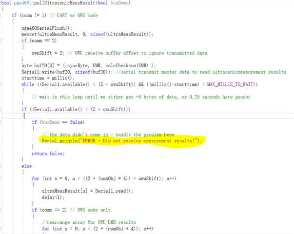

I want to use serial port communication with a PGA460, the program uses GetDistance, but it appeared error - did not receive measurement results!
I checked the library program of the PGA460 and found that there was a problem starting from the note which I marked yellow:
Please help to analyze.

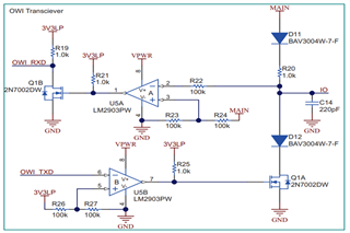

  • Hi Kailyn,
    From the schematic snippet, I noticed that the RXD and TXD pins are not connected to anything.  Are they using one-wire uart on the IO pin?  If so, do they have a one wire interface circuit, similar to the one below:

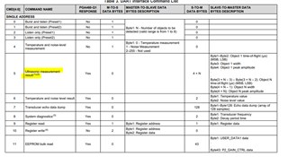

  • Hi Kailyn,
    To get the ultrasonic measurement result, you would need to send the command highlighted below instead of reading a specific register.
    However, before sending the highlighted command, you should make sure that the DATADUMP_EN bit shown below in the EE_CNTRL register is not set:

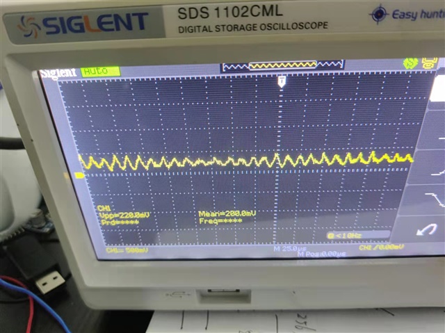

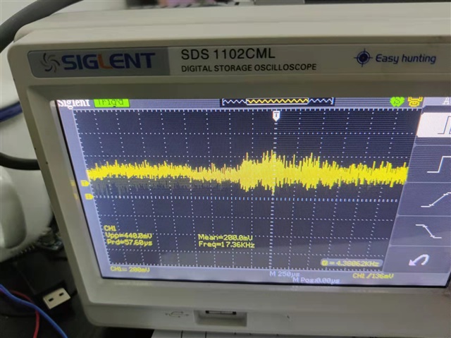

  • Hello Mekre,
    Thank you for your reply.
    The customer has no logic analyzer and he tested with oscilloscope, and we could found that TXD has almost no signal and RXD has noise as below:

  • Hi Kailyn,
    I would expect there to be a voltage on the RXD pin, but the waveforms do not show this present.  To verify that they are probing at the right location, can they try running the command that they mentioned works correctly to see if they observe something on the oscilloscope?
